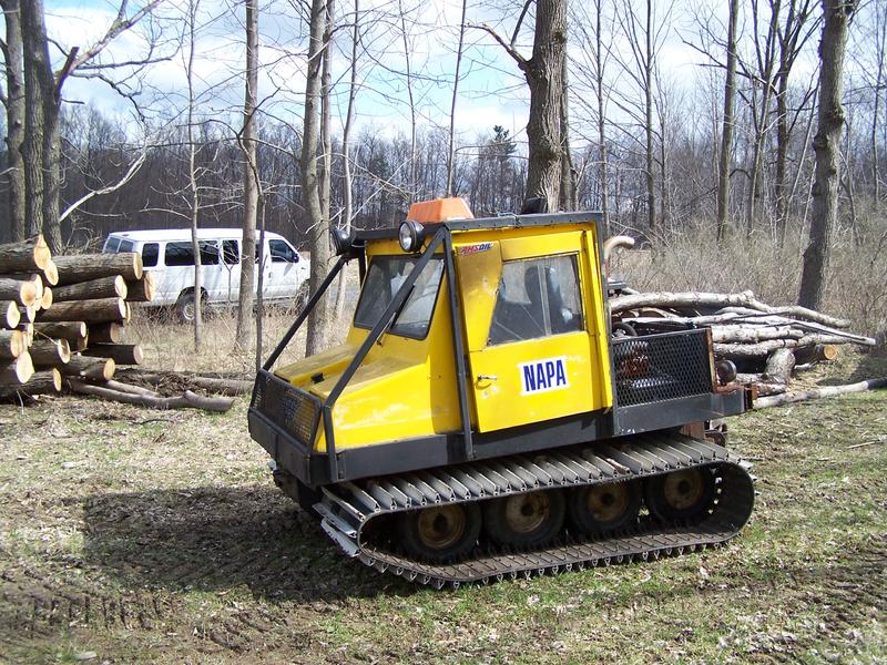

I picked up a bombi that had a good run in Maine taking care of grooming duties for a snow mobile club.
(I am new to snow cats so my desire blurrs easily with my needs) I felt It fit my needs:
Cheap.
Distressed.
Automatic.
Diesel
was being used when a track failed.
Medium sized
The photo below is when I first picked it up.
I intend to get it sorted out and operating this winter.

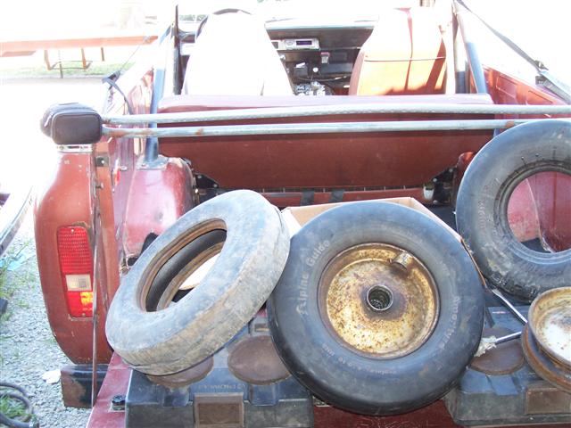

Mounted the solid tires.

Looks good, Mike. I'm glad to see it back together.
An articulated double-Bombi might be a fun project.
Keep us updated !

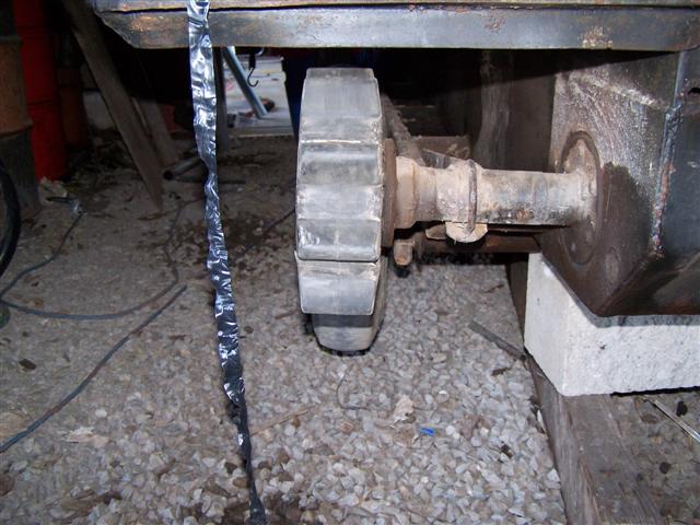

wooo whooo. Squeezing rubber is really interesting. man do those deform before they get where they are going.
Any how. The alping guides that came with it are mounted.
More Baby steps.

Don, my last one came with a nisson deisel in it. It was kind of shy on the rust protection. It pulled some very heavy loads.I hated to see them go.
