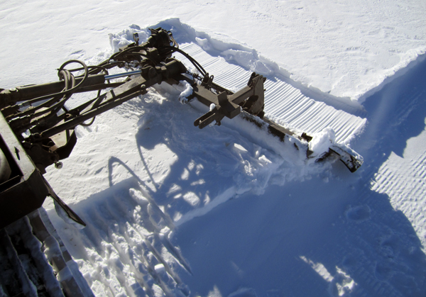

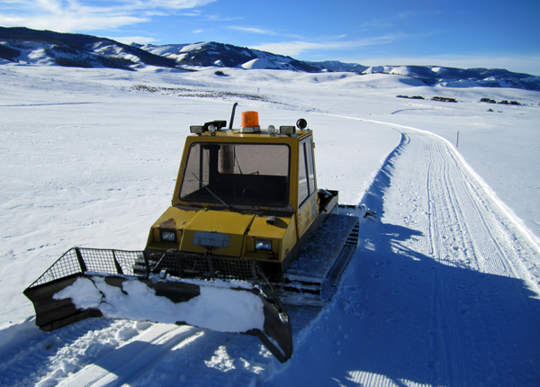

I've had this machine for two winters now. We've used it to put in groomed trails for a couple of sled dog races here in Colorado. When it's working, I'm pretty happy with it. When it isn't working, ugh.
It busts through untracked snow no problem, and the blade and compactor bar work decently enough. It is not easy to operate smoothly, but I get better every time I use it.
The factory hydraulics & attachments seem pretty rare - I'd love to hear from other people that have used one of these with the grooming attachments, and their experiences with them.

The C-bar does have a float position, and it pivots freely side-to-side behind the cat. It tracks OK behind the cat, as long as you are turning it smoothly. On major sidehills it will fall to the downhill side. The compactor is supposed to have adjustable down pressure in the float position. This is done by fiddling with a little knob on the C-Bar itself. Pretty sure mine does not work - I have not had any luck adjusting the downward force.
The blade is not as big as it looks in the photo. But with the relatively short tracks, I do get some porpoising action going down the trails. This can usually be controlled with good driving technique, or simply by slowing down. I helps to use the blade and C-Bar at the same time. adding some fore-aft stability, but I cannot always use both because I quickly loose power and steering ability. Best to just track-pack the trail, use the blade here and there where needed, and then go over it again with the blade up and the C-Bar down.

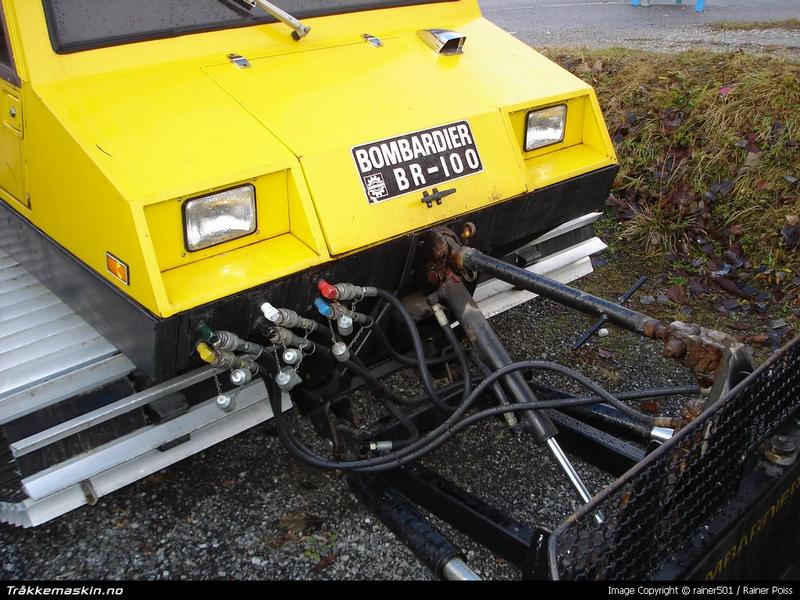

brianf i thik your exactly right about the pump under the seat , iv seen them in pics on other threads and if that was the hydraulic pump there would not be any pumping going on unless the trans was turning . boneyard if you get a chance i would love to see some close up pics of the motor to see how the hydraulics are mounted . by the way do the wings open up on your blade or is it a strait U blade ? thanks
Tim

Tim- I would be happy to post some pics of the hydraulic set up next week, the cat is at a remote location right now. The U Blade wings are fixed, it's just a 6-way blade, although the curl is also adjustable, but it is done manually on a large threaded shaft with a turnbuckle.

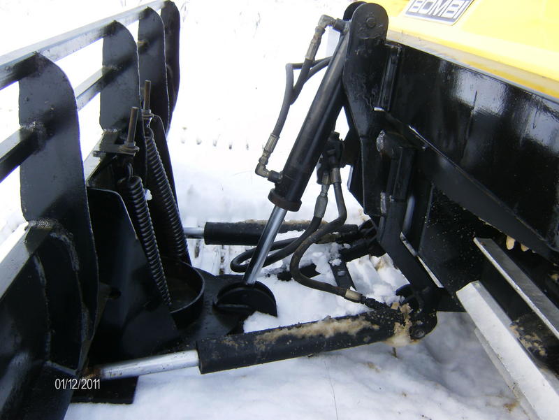

here are some pictures of factory blade set up

nice pics brianf very handy for stealing ideas . are those machines both yours ,would love to see pics of the rest of the machine . can never have to many snocat pics to look at....
Tim
the 100+ was just a reference pic I used to build a couple of blade frames for my machines, the other pics are from a bombi with factory blade that I just sold to another member here

the bombi came with a optional front blade ordered from factory, they have a bolt on frame assembly that goes under machine follows diff bends and bolts up onto front bumper, works great I have never had break or even bend, on that note they are fairly rare to find on bombi, most only ordered hydraulics with rear outlets for drags, if you have bombi parts manual they have picture and even part numbers, but I am sure they no longer stock these, but you never know I have ordered parts and surprised when they are still available or they have more made.
be careful of home made blades I have seen some that had lower mounts welded onto diff housing without heavy plate, caused bent housings and broken welds on housing
