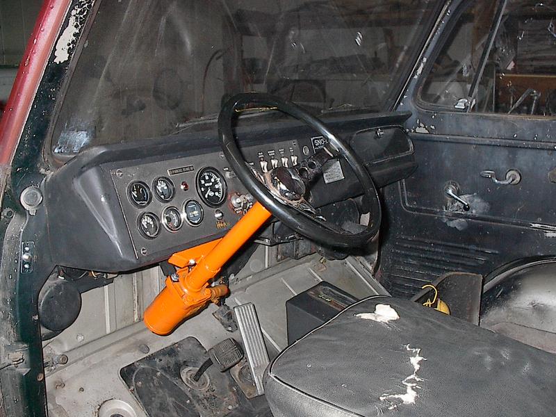

Here are a couple pictures of the project just cause you claim to like pictures.:smile:Aaron

Aaron,
Welcome to the forum.
I've had three Tuckers and every one had what I assume you mean by "swing limiters".
These are brackets welded to the carriers. As the carrier pivots around the axle (to maximize the track's contact with the ground) these brackets (one bracket at each end of the carrier) contact the bottom of the leaf springs preventing the carrier from rotating too far, and preventing the grouser bars from contacting the frame, etc.
Perhaps yours were cut off by a previous owner?

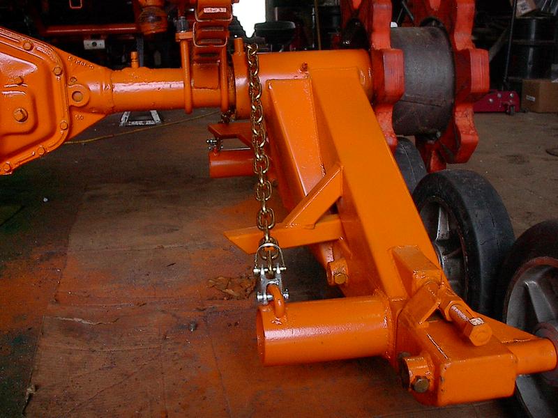

Yes mine has those tubes that contact the spring hangers also, but the tracks hit the frame before those brackets hit the hangers. I'm Really wondering if track frames were changed at one time because My machine is a 1642 but only has 5 rollers? I am going to change the stops to do what they are suppose to when I have the tracks off. The van body is a few inches lower than the frame now as well. Keep in mind I'm just having fun with mine so I'm climbing over snow banks and up and down ditches, etc. ; not stuff you'd do if it was still a groomer. Basically I spent so much time doing the conversion that all the details have gotten left undone; but what fun would it be if it wasn't a work in progress?

Aaron,
A 1642 would have six idler wheels per carrier. (That's the correct term for what you are calling "track frames".) If your carriers only have five wheels, someone swapped carriers along the way.
Looking at the right front carrier in the photo you just posted I don't see the bracket I mentioned. Also the brackets differed slightly depending on the cab configuration. Some of the carriers I've seen had extensions welded to the brackets which restricted the rotation of the carrier somewhat more. I have seen those extensions on all of the front carriers and most of the rear ones.
I'm wondering why it would have had the track carriers changed? It couldn't have come with pontoons originally could it have? It was originally ordered by the National Park Service in NY and When I picked it up it had finished a couple of sentences grooming snowmobile trails in MN. It was 30 years old so who knows what it has seen? Mine has the stops coming straight out on 7 corners and one with a vertical extention on the passsenger side rear corner. It never made any sense to me why only the one, but if the carriers are a mixed set, that makes sense. Thanks for the info.

Aaron,
I'm no expert, but I've never seen a photo of a pontoon equipped mid-engine Tucker. They did offer the pontoon style steel tracks up until about 1982 or 1983.
Changing carriers isn't that difficult, and buying one machine to swap longer (or shorter) tracks and carriers while not necessarily common, probably isn't all that rare, either.
On my Tuckers the swing limiter brackets are probably only two or three inches away from contacting the bottom of the leaf springs. That's with the machine parked level.
Looking at the photos you provided I don't see the brackets in front or on the left rear.

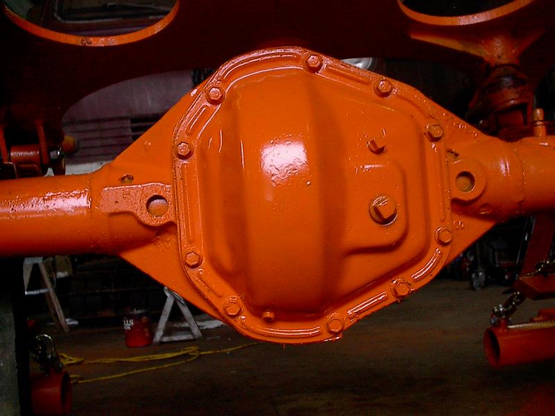

I noticed your rear differential cover has a pipe elbow and plug whereas your front one does not. One of my Tuckers came with those (front and rear). I think those are a good idea as it allows a higher gear oil fill level in the differential. I believe those are factory.

I'd love to see some pictures of your brackets, They are obviously a lot different than mine. Mine are near the ends of the carriers, I'm thinking yours must be closer to the axle?
The front had the elbow on the filler also wich I removed thinking it was added later and it made it a little harder to fill, maybe I should put it back on.

Aaron,
I'll try and get some bracket photos tonight and get them posted tomorrow....
When you turn your steering wheel all the way, do your front and rear tracks hit? The reason I ask is the 1600 series tracks are asymmetric. They are 16" longer each than a 1500 series. IIRC 13" of that is on one side and three inches on the other. The longer ends are placed at the outside. So a 1600 series machine would have tracks six inches closer together in the middle with the tracks oriented straight. I believe Tucker put a block in the steering hydraulic cylinder to restrict its movement and prevent track-to-track contact.

No my tracks never hit. Before I shortened it there was plenty of room for 6 wheel carriers and even after shortening it 16" They still don't hit even when turning while climbing a snow bank. I had calculated that I could take 18" out but 16" worked better so that's what I did. There are steering stops welded to the front frame rails. I assumed those were so the steering cylinder could not bottom out. I assumed all models had them. My tie rods aren't exactly centered so it does not reach the stop when turning one way but does the other.

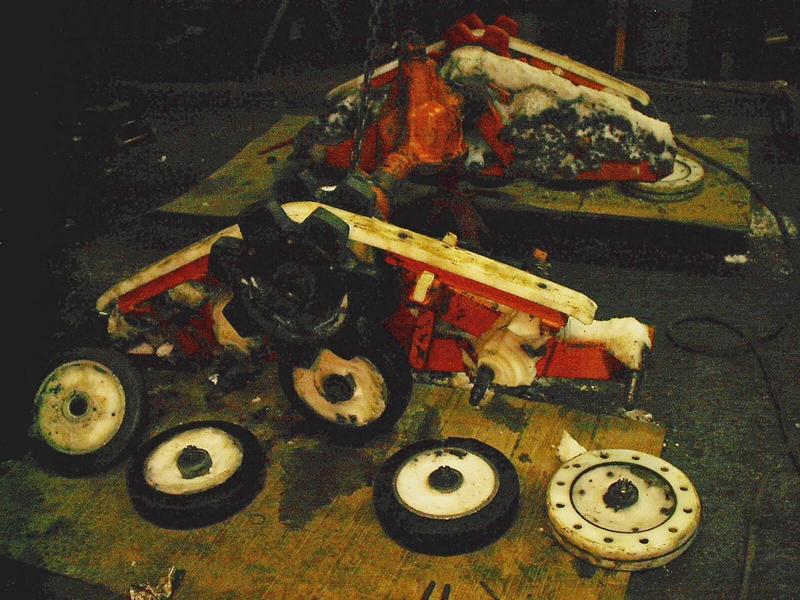

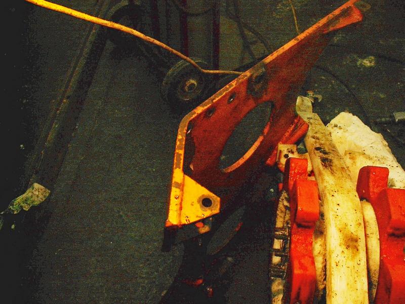

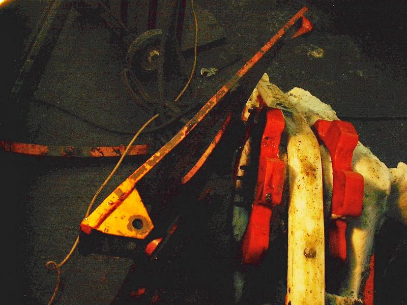

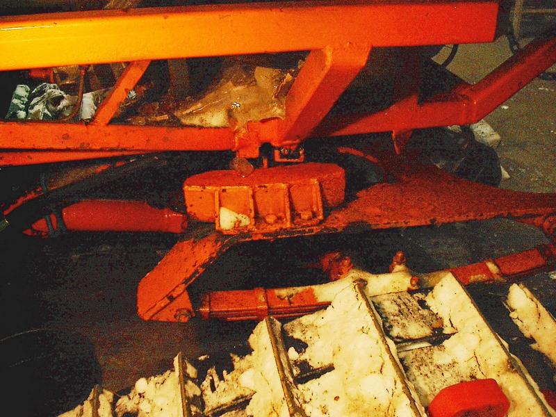

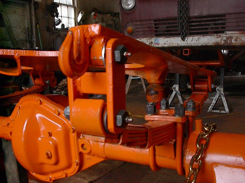

I tore into mine last night and got a lot of it apart (I've always been good at taking things apart:wink:) I was also able to straighten the bent 5th wheel plate in our press and straighten a few other brackets that got bent as well. I need to get three brackets stick welded (I only wire feed) back on the frame and a couple of cracks welded up then the damage from the extraction will be fixed. I'm doing some other mods to the carrier though and still need to service all idler bearings and sprocket bearings.
Sorry for the poor quality pictures, I only had an old camera that the flash doesn't work on and a poorly lit shop.:glare:

Aaron,
Glad you got the cat back! It must have taken some serious pulling to bend that fifth wheel plate.
I stupidly forgot my camera last night so it will be early next week before I can post pictures. I'm sorry for the delay.
In your last photo that shows the carrier assembly on the right side just above the plastic hyfax is a bracket that looks like a swing limiter.
When I had my carriers off the machine Jeff Godard at Tucker recommended I remove all the spindles from the carriers, clean them up and reinstall them after liberally coating them with Never-Seize. He said they get rusted in and it's a real pain to change one in the field after it has rusted itself to the carrier. I followed his advice. Some were a bit recalcitrant and I'm glad I did it.
It looks like your sprockets and idler wheels are in very nice shape. If you price those you'll see you got a steal on your Tucker!

Yes that is a swing limiter just wondering if yours are different.
Freeing up the shafts is a good idea; I need to replace a few of my shafts now. I replaced two last time I had the front tracks off. I have two idlers that are seperating on the rear carriers but yes overall I got great sprockets and idlers. Those urathane ones came new as spares with the machine, but they didn't hold up well at all. Ice on the grousers chewed them up the first year I put them on. I will flip them now and use them up before putting rubber back on unless someone convinces me there are better quality urathane available now. They say sno-cat on them so I'm thinking they are Tuckers own sprockets?
I think you're right on the longer length of MEs The rear driveshaft is a slip yoke welded to a ujoint (no tubing) The machine could not have been any shorter as the radiator was very close to the cab and the cab was small the way it was.

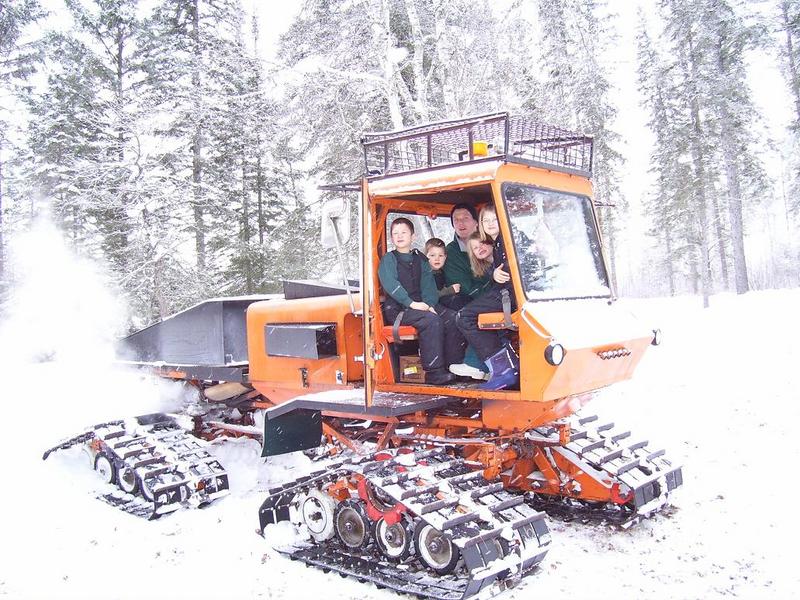

Hey guys, I finally got the beast back in the snow last week and got to take the family out for a couple of hours last weekend. I am very pleased with the performance of the tracks after removing the front slide sections. They are very quiet in the snow and I haven't noticed any problems with them whatsoever. I even opened it up on a hard packed road with no problem with vibration or flopping of the track. Both front tracks are in the loosest position and are by no means over tight. Here are some pictures as I put things back together. Notice the new fill plug I put higher on the diff covers. The only "problem" with this was it showed me that the front pinion seal and one rear sprocket hub seal are leaking; good things to know of course. The reason I did this was because all four hub bearings were pitted and after replacing them I figure the more lube they have the better. After filling the front diff with 9 pints of 80-90 I let it set overnight so the lube could run through the bearings, I was able to put 3 more pints in for a total of 1 1/2 gallons. It is now a little over half way up on the axle tubes. I'm also thinking I should run the vent tube up into my engine dog house just in case I ever dunk it again it will have a chance to keep out the water. Also note the shortened slides and new pull brackets and chains I installed. these can also be hooked to limit travel of the tracks when crossing soft spots in the swamp roads or ? One more mod I did was to put brass bushings in the springs and modify some bolts with grease zerks. This really tighted up the front suspension!
