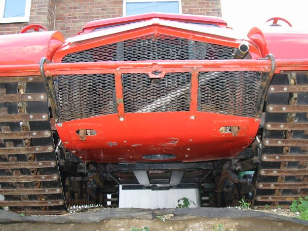

Below is a photo of the front of my ST4 where you can clearly see the exhaust sticking straight out the front!!! :eek: (front driver's side, chrome tube sticking out of the grill)

Well I can tell you it is not a good thing, especially on days when the wind is not blowing. Anytime you can drive with a cross-wind is good. But on days when there is very little wind you don't want to sit at idle very long. And even driving forward is not the best thing.
You can see the exhaust behind the lower grill, it comes from the lower left up to the upper right. My thought was to run it back under the cabin like Villi did, and like the original set up would be.

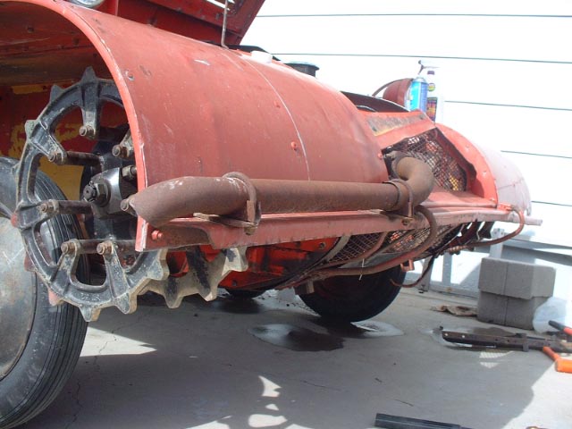

After using mine for this last winter I never experienced any exhaust fumes in the cab. Dmiesner's has a dual set up like mine but one going left and the other right. Its built into the front bumper. The bad thig was when I went to look under his Snow Master and grabbed a hold of the frint bumper. Can you say HOT! I played it off pretty well though. Anyway I still like the idea of it going outback and up. I just cant figure out a way of really doing it yet. If it goes under you cannot have any joints. Heres a picture of my set up.
