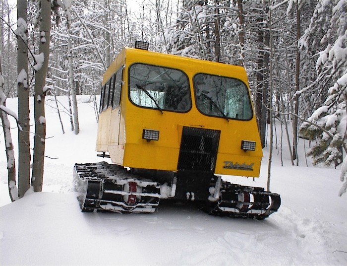

I finally found some time to post a few photos of my 1402 IMP that has been totally rebuilt and modified. I purchased the machine to use for cabin access in the Uinta Mountains of Utah. I added the full cab right after I purchased the machine. It even required a engine cover. After running it for the first couple of winters, I decided to make things even better by adding torsion axles to the chassis. Someone re-engined it with a 2.0 liter engine from a 1972 pinto before I purchased it. I added a C4 tranny to it so my wife could drive it. It comes it at about .40 psi ground pressure now and will go anywhere in our soft Utah snow. A real sweet little machine!:thumb:
What is a 1402? The 1402 used the same chassis as the 1404 but didn't have the front cab. It had just a windshield. It was to be used like a tractor to haul things. It originally had an Wisconsin engine and was sinfully underpowered. I talked to some original Thiokol empoyees about this machine and they where confused about the squared off forward lower chassis. They believe it could have been a prototype or special order. The simpler front end made it lighter than the 1404. It has a more modern look than the 1404 in some ways. :wave:

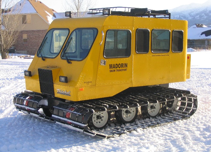

I noticed you change the track design from the original raised center ridge type tracks to a wider flat snow type track. Is that to help with floatation on the powder snow you get in Utah? I remember when I used to ski a lot, the bowls near Park City had much lighter snow than anything I'd encounter in Colorado.
Also, when you had the original tracks on your machine, did you find that they made it more suitable for non-snow/low-snow conditions?
Also, I noticed you now have fewer bogie wheels. Did that affect the ride? And how?
BTW . . . how about some interior photos!
I really wanted to get away from the drop center grousers. :eek: So I studied several snow cats to see what worked well. The strait grouser gives the cat more ground clearance. I liked the design of the later model Imps and LMC tracks. The strait grousers on the Super Imps were designed to give it some height. The Sprite/LMC 1200 has a very good track, with the multi-belts to help shed snow.
My first test of the new tracks proved that they worked well. I found the machine to turn much better. It also works better in shallow snow conditions, since it didn't tear up my yard near as much as the old track.
The real test was climbing in deep powder where I saw an improvement in too. This I think was due to the taller grouser and many more paddles.
The bad part of it all was it took me nearly all summer to make the grousers and tire guides. Alot of man hours.

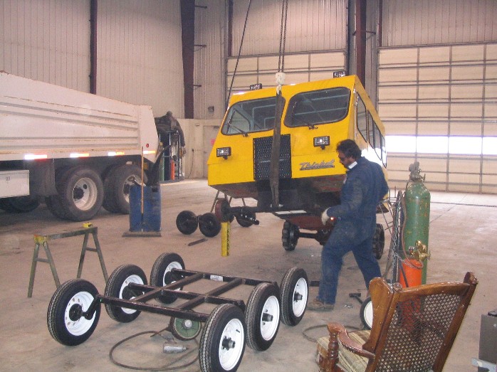

The torsion axles with larger wheels was a huge improvement on the ride. My friend who grooms Dear Valley Ski Area was shocked at the difference. He said it rides like a big cat now. It's logical, if you run a larger wheel over a grouser, the less impact it will have and a smoother ride.
With larger wheels, I was able to reduce the number of wheels that a IMP utilizes. I have also seen some Leitner cats in Europe that run with large gaps between the tires, mostly in the center section. So I felt that was not so critical.
It was worth all the work that I put into it. I only wish that I would have droped the forward idler wheels and just put the front axle further forward

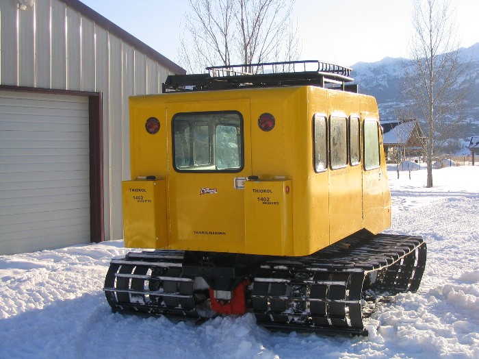

Here's a couple of photos of the cat from behind and with the old drop center tracks that where widened. The gas tanks where added to the rear of the machine to keep it out of the cab.:eek:

I used three axles. They can be custom made to the width that you need. Next time I would remove the forward idler wheel and just run the front axle up front like the 1200 or 1500 LMC. That would give you more ground contact. Also, the IMP could do better to have the C-4 differential relocated a little more aft. You also need to lower the rear differential about 3 to 4 inches. I raised the whole chassis to get better ground and track to cab clearance. It takes alot of planning and calculating to get it right.

The torsion axles mounted under the chassis added nearly 4" to the chassis ground clearance. If you leave the differential where it is, the drive sprocket would end up about 4" to 5" off the ground. It is desireable to have the rear drive sprocket off the ground approx. 1.5 to 2" to give it a smooth ride. ( no suspension in the rear differential ) In the rear photo above, you can see the 3" aluminum spacer that was added. The differential was dropped with spacers in the front so that the drive shaft barely clears the belly support. It is then angled downward to the rear of the machine. To gain differential clearance Thiokol went to strait grouser in the C shape. The strait grouser gives the rearend an instant 1.5" of clearance as far the belt to differential over the drop center grouser. Adding the taller C grouser even added more lift. This comes right from one of the original engineers in Logan. I will follow up with a couple of photo's to show what I mean.
Of course some cat's don't intend on using the drive sprocket for floatation and place it high up in the rear to get ground clearance. A cat like the IMP that has the drive sprocket slightly off the ground will get floatation in soft snow yet additional ground pressure on hard packed snow. It will also help a lot in the turning abilities of the IMP to have it slightly elevated.
Here's a photo of the later Thiokol Strait grouser. Compare it to the very first photo of my 1402 with the 24" tracks or even the modified asymmetrical track of my cat above. "The belting which gives the support on the snow is almost 2" inside the circumference of the tires." ( giving up clearance! ):(
Here's a photo showing the rear sprocket about 2" off the ground. "Some IMP's have leaf springs so worn out that the sprocket rides on the ground, giving the cat a rough ride on hardpack snow.":mad:
Look through the sprocket an see how much higher the differential is off the ground verses a drop center track.

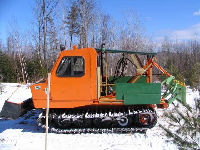

You have a nice looking IMP 1404.
Does it groom or push snow well?
I think you said that you made the blade and compactor for it.
I'm going to build a drag for my DMC 1200 this fall to groom some roads in the Uinta's. I plan on coping the mogul master and a couple others I have seen.

Thanks, Nutsster. It does push snow well. The green thing on the back is for winching and skidding logs. We didn't have much snow here last winter so I haven't gotten to use it much. It came with the front blade.
I will probably be too busy in the next year or so to do anything about the tracks. I have other ways to move logs in the non-snow months , so I'll just hope we have a real winter next year :17875:

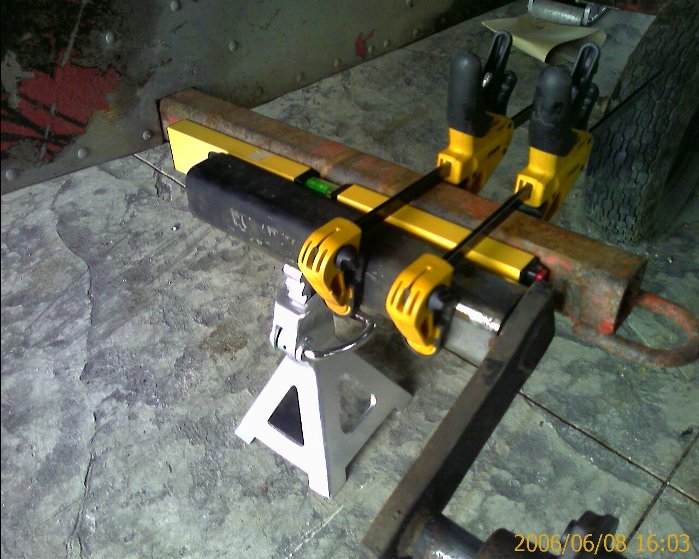

I was really intriged with the torsion suspension and did a little home work over the last few days, let me know what you think about attaching 2 opposing torsion ends to the existing suspension support tubes?
I was able to locate surplus 1300lb torsion axles for $60 a piece. They are only about 3ft wide but as you know the torsion "guts" only extend a foot or so into the axle tube. Extending them with 2 1/2" stock or cutting them off and attaching as is failry simple. Whats your thoughts on this approach??
If anyone is interested, the place I found has about 80 of these surplus torsion axles in stock.....only about $60 a piece.
