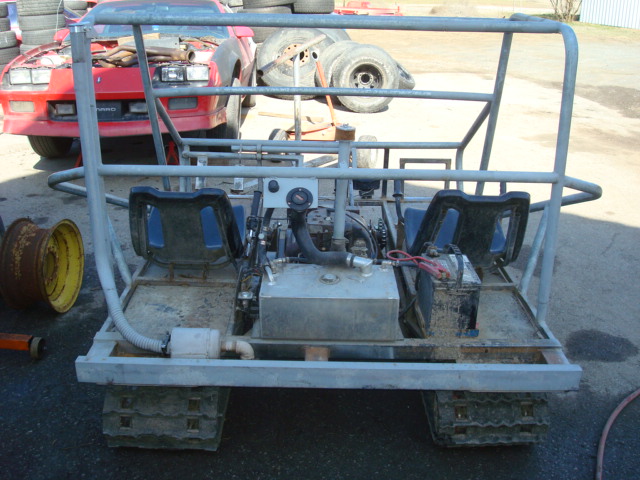

I built a mini snow cat in about 3 weeks out of two snowmobiles & some scrap. works good, gona build some more. Check out the video. [ame="http://www.youtube.com/watch?v=45Mr6neXGhI"]YouTube- homebuilt ATTV[/ame]

Do you have any of the build up photos for us so you could show us how it went together? And perhaps some added specifications?
Yamaha tracks & suspension, K 131 kohler moter ( a little under powerd ) Haxco transaxle W/ 2 foward & 1 rev. jet ski fuel cell, subaru brat seats,
twist throtle off a honda motorcycle, 1x .125 square tube & 1 x 2 rec. tube, a little bit of angle iron, the 1.5 dia. round tube is from a trampoline.
That thing is cool!!! And yes, it is already better than most krusty's since it moves under it's own power and has seen snow.

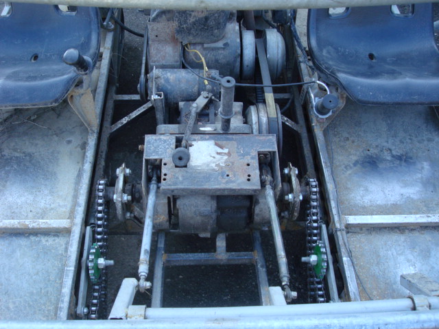

Now, how does it turn? Steer? Is it like a skid steer setup where one track brakes in order to turn?
I'd love to see some up close/detailed photos.
What are your plans? You obviously built a roll type cage, is that going to be the frame for some future body work? Possibly a flat bed for cargo over the rear? Or since you indicate it is underpowered is there a new powerplant in your future plans that might give it a bit more oomph?

The build photos will not upload, too big i think.

When i build the bigger one i am gona build every thing including the tracks, i just need to find a pair of drive sprokets i have most everything els, It will be at least 2 x longer then my little one.
gona do a 2 to 1 chain reduction on my final drive so it will drop my gearing but still give me a good top end speed. every thing i build are one offs, no two are the same only becuse i build outa what ever i have laying around or what i can trade for.
