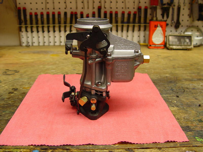

The kit that I used to rebuild my Ball & Ball is a very good kit, Part # P15021B However, I don't know the Manufacturer of the kit, I can find out for you if need be. I purchased this kit from my local parts store (not a chain type of auto part's store) a family owned store, with guys behind the counter that drove cars & trucks with flat heads in them back in the day. They just asked for the numbers on the carb. and then handed me this kit "with out" looking on a computer....Pretty amazing now a days.
Also, if your float is a good one, take very good care of it, they are no longer available any more, from what I've been told.

I rebuilt a carb using the Vintage Power Wagon kits. Lots of bits and pieces that weren't useful, but most of the important stuff worked fine. The exception was the piston of the pump assembly (see previous post and picture). With a little bit of work I solved that problem and the carb has been working great for a year now. The other carb I had went off with another J-5 I sold before I got it fully put back together so I don't know if history would have repeated itself.

That's the kit I can find, your carb has that rib over the bowl cover, mine does not. From what I gather mine is an "industrial" model of that BB carb.

Same for me. Weatherby's carb doesn't look anything like the two on my 1960s J-5s. The guy that runs our NAPA has been doing this for nearly 40 years and is also familiar with this particular flathead as there was a time when lots of Bombardiers were running around here. The only kit he could find that had a chance of working didn't contain any useable parts. I suspect these parts would have fit Weatherby's.
My advice is to get the kit from Vintage Power Wagon. The gasket (2nd most important part!), plugs, jets, and other brass bits are correct and need no modification. All you need to do is modify the shaft of the piston and you'll be all set. It's actually a pretty easy modification to make. Hacksaw and hand drill will do it, but a grinder is very helpful.

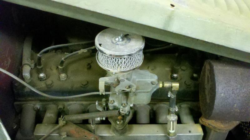

I had this very same problem. I ended up making the same mods to the accelerator pump and had thank make my gaskets. Bad news was after all the work it still didn't run right. What I ended up doing was I put a round top ball and ball carb on mine. The napa kit worked perfect. I also changed the oilbath air filter over to a paper element chrome
Filter from a vw worked perfect. Save yourself the trouble and switch over. I got lucky and found mine at my father inlaws house on and old flatbed dodge with a flathead six. Free. I will be selling my complete running motor and possibly the trans soon.im stuffing a small block chevy in mine. If anyone is interested let menow.775-427-1976

This is pretty much where I am at. I rebuilt and made my own gasket, but now the throttle body leaks gas. I've been contemplating the changeover but was held back by the air cleaner. Any chance you can get some pics or part numbers?
I was thinking of finding a K&N or some other confilter to adapt it, but the engine cover seems to get in the way of mounting it straight up. Possible some tubing?
Yea I can get some pictures but it will take me a day or so. I used a aftermarket VW aircleaner. They are low profile and slip on. I screws mine into the carb and siliconed to seal it. Then the very top of it comes off with just a wing nut for changing the filter. I don't remember the part number or the make. But I know they are all about the same for the stock vw.I think I paid about $15 for it. It looks like a little small but works fine. A guy could always stack two for more air flow. If you or anyone else wants more info or explaination on how I did mine just call me my number is in the above post. Also if you wanted a preformed radiator hose would work to connect the stock oilbath filter. I switched for better preformance and because mine was leaking oil everywhere.

Also somthing I forgot which might be a problem for others with stock manifolds is the fact that mine are custom built so im not sure if your carb will be in the same location as mine.
