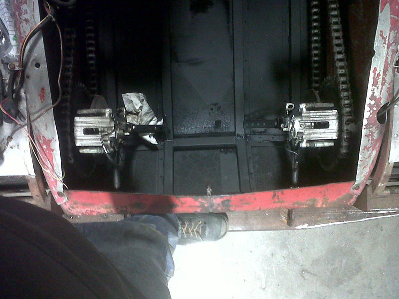

Here are some photos of a ST4 that I installed a Subaru EA82 in. I got the transmision adapter from Kennedy Engineering and the rest of the install was fabricated. While I was installing the new engine I installed disk brakes that were salvaged from the rear of a 2007 VW Beetle. The engine puts out close to 90 hp and is a good match for the Sno Trac chassis. I have put close to 60 miles on it since the new motor was installed and am very happy with the results.
