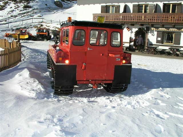

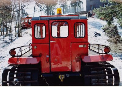

I have been finding out that I am in need of some rear deck snow guards. In powder my tracks tend throw powder up and back forward from the back of the tracks. This powder build up gets very thick! today on a rescue mission to recover my neighbors Excusion :D I drove about 5 miles in 12" plus of freshly fallen snow. I must of had 12" on my track decks when I got to his vehicle. I have seen some type of guards on other Snow Masters (see pics) Does anyone else have these? I believe when my vehicle goes to the metal shop I am going to have them build me a set.
(Pics not of my Snow Master)

Re: In need of rear deck snow guards
Villi,
My tracks stick out about 12" past the back of the machine. The tracks then are free to fling the snow farward from the back onto my track deck. Thanks for the pictures. They gave me another idea!

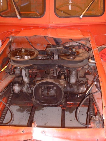

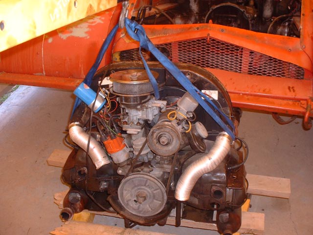

Pulled the engine today
Well I finally had the time and almost the right weather to yank my engine out of my Snow Master today! With one hand not quite up to par I was able to get the engine out in about 3 hours (basically 1-1/2 hands). This also included 2 hours trying everyway to get to the drivers side lower bolt and actually remove it. I could feel it no problem just couldnt get anything to it to loosen it up! Figured out a way to do it with out yanking the entire exhaust system off (heater boxes). But next time I will remove all exhaust and heater boxes first. BUT all was good. I pulled the motor up and out from the top. I have come to realize that it would be much easier to remove the motor from the bottom. BUT I did learn alot and the next one should be out in a hour or so. I will post some pictures Tuesday sometime. I am still amazed at how light these motors are. Next will be the removal of the variators and then the transmission. I will also be rebuilding this motor to a more potent and much better engine. This will be going into my next up and coming Snow Master rebuild. Should be a fun rebuild. Its a good motor but I have a special need for a better more powerful and highly balanced engine. I will discuss that later on as that engine rebuild progresses. For now I still have to finish this complete frame off restoration (with many many improvements). Should be a blast! Pictures Tuesday.

Re: Pulled the engine today
Pictures

Re: Lower Engine bolts:
The 2 lower engine bolts are actually studs, Metric, and would have a 17MM nut on a VW, but Snow Trac used a 15MM. they are so hard to get at that almost everyone cuts a 1/2 slot, from one skid pan support to the other so that it can be accessed from the bottom. Just did this conversion to Earl's rig. You shouldn't have to remove the heater boxes. In your specific case it would be necessary to remove the extractor exhaust.
Hello Lyndon. Hows Alaska? Thanks for the info. The two lower fasteners were 17mm. Actauly three were 17mm and the top right (drivers side) was a 15mm. Next time I will do the same. The bottom left wasnt to bad. Next is the remaval of the variators and transmission (see your PM box). Any suggestions before I dig in? I will be pressure washing everything first though. Its completely covered in grease and oil. Rear main seal was leaking and I over did the greasing my first time around. Live and learn.
Alaska is Great! It's about 30 Deg. ducks are out everywhere, some light snow. Spring is just around the corner. No bugs yet! when you go to pull your transaxel/variator make sure you don't loose any of the specialty hardware which consists of some machined spacers at or near the bell housing, and the special flat rectangular nuts that are on the long bolts going back to the 2nd frame member. these are double nutted and the nut on the other end of the rod, the variator end near the sprockets, is braised or welded on. If you crank on it with out backing off the double nuts at the other end it usually breaks the weld/braising. they should be 13/16 and require a thin wall socket.
