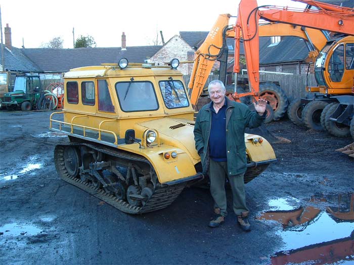

Very nice Tommo! Is that you in the pic as well? If so your shoes are untied.:D Very nice Snow Trac! You belting on the tracks looks very stout! I wonder what type of belting they used. Now its clean her up time.
I think that is Tommo's wife. :eek: :whistle: Those English women are real beauties! :yum:

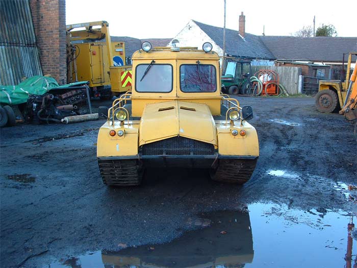

TOMMO, First thing you need to find is a good rubber seal for that air intake sheet metal (top of air intake box) that creates a tight seal and draws cool air in from the outside. If its not sealed it will draw alot of engine compartment heat. Change the engine oil and transmission fluid. You look like a big man so it will be a difficult job getting to the drain hole on the transmission. The fill hole is the hardest though. I still have the bruises and some kinda knot under the skin when I was trying to fill and then retighten the cap. Goes with the territory though. (Hire someone to do it if you have big hands!) If you decide to go with a paper airfilter let me know I will buy your current air intake assembly. Also get the "BLUE LOCTITE" This is a medium strength but is designed for nuts and bolts that are taken off frequently. This is a tracked vehicle and vibrates a bunch on any surface but soft snow. ANY nut and bolt or fastener that is not torqued down will simply vibrate loose. If you apply a couple of drops before you tighten then it wont vibrate loose. (Not needed if you have nylock buts) But Nylocks were designed for a one time use so keep that in mind. You will want to use the best gear lube you can find for your transmission. This is the biggest pain in the ass area to change. Other than that I am available by phone or email if you need any help. You can PM me too.

Looks good there, I like the yellow! Are those indicators stock, kinda look like Landie ones :D

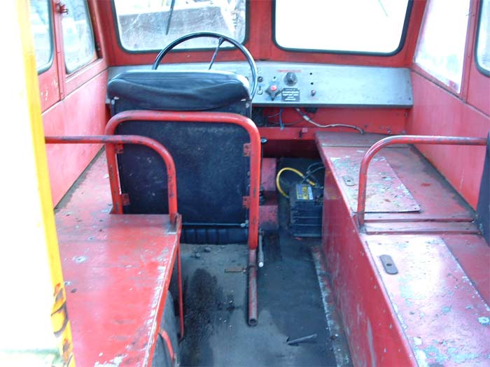

your dash indicates that this was purchased in scotland , maybe someone knows about this dealer , and maybe there is some materials . etc. still floating around the area. i have attempted and done some searches maybe in scotland and provide some details.
perthshire scotland alex maclarty ltd. crieff scotland its near perth or atholl.... close to robertson country..... g. robertson

I have exactly the same dash tag on my Snow Trac, but since I personally imported mine from England it makes sense mine should have that tag.
I wonder if the guys in Alaska, Canada or in the western USA have a tag that identifies the North American distributor? And what about the folks in Europe or Iceland?
Is there some sort of tag or other indentifying mark on your Snow Trac (perhaps in a different place???) that shows your importer or distributor?

The 'thing' in the photo is not me nor my wife (Fare to good lucking!!), but a 'Scottish Yettie' that some how stowed away in the track on route to the south! I have managed to train and domesticate the beast, but as you can see, tying shoe laces is going to take longer than anticipated! Ug,Ug.

The name plate on the dash has far as i know, is the Agent (Name on plate) from the Salvage squad show, who imported them from Sweden and bought all the spares from the company when it ceased trading in Sweden and carried on for a few years in scotland until the early 80's?? I could be wrong though!
Some things for you fine bunch of people to answer/advise me on!
1) Seat frame: Original or non std?
2) Boxed in seat benches with hatches!
3) Name plate on dash?
4) No turn signal lights on top corner of window/quaterlight area!
5) Wiper motors above windows!
6) Exhaust, full length under slung.
7) Info plate below number plate/above tail lights!
8) Front indicator and side lights! (Nice Mod)
I think the turn signal and side lights where ordered with the vehicle and the rear lights are add-ons since old ones where broken off?
The front lights are in deed from Land Rover's. Most 1950's to 60's cars had these style of ruby (Glass) held in place by the chrome circle which fitted into the rim of the rubber internal gaiter. Cars like the Riley, Austin, Morris, Ford Pops and many others came with this style, which matches the year of the Snow trac, 1965.The Scottish Electricity board would have asked for the modification to have been made at purchase or by there fleet management section within the company soon after arrival and before being road registered and going out on task.
Hey, how was I supposed to know that was your BROTHER in the photo, not some frisky English hottie? :whistle: Besides, Mith had previously described lovely English ladies to me so I figured it must be!
1) the seat frame is an early model frame, commonly seen on models from the 60's . . . also you have 6 lower bogey wheels instead of 4, so that would correspond with the seat frame.
2) never seen that before!
3) exact same name plate as mine
4) lost?
5) some were top mounted, some were bottom mounted. I don't know when or why it changed.
6) that is the orginal way they did it, under the cabin and I think (not sure about this part) out the right side through the track in front of the large rear wheel.
7) that is where mine is
8) ?
EDIT: Tommo, here is a photo from a 1963 owners manual. It shows a seat frame that is the same as your seat frame.
I too have the Alex MacLarty name plate on my dash - they were the distributors of them up in Scotland. I have managed to track down the firm, but the chap is not forthcoming, have sent them two emails and made two phone calls, but have got nowhere so far! I have a feeling that they may well have actually built my snowtrac, but that is only a guess, I am pretty sure it was made in the UK as it has too late an issue number to have been made in Sweden.
