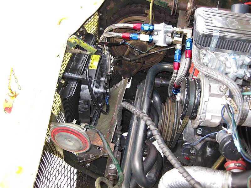

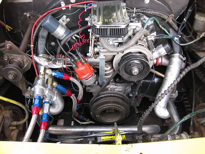

Here's some pics of the external oil cooler I installed on the Snow Trac's vw engine. The oil lines route oil from an aftermarket full-flow oil pump behind the crank pulley, through a mechanical thermostat (H-shaped casting attached to braided hoses), and through an oil cooler mounted in the front grill. An oil filter housing and thermostat sandwich adapter will take the place of the thermostat. A mechanical thermostat allows cold oil to bypass the cooler and filter during warmup, allowing the oil to warm to 180ºF before opening. The thermostat also prevents cold, viscous oil from blowing out the filter body/seal, and prevents possible bursting of the oil cooler as cold oil pressure in VW engines can reportedly reach 300 psi upon starting. There's also an inline thermostat for the cooling fan on the outflow side of the cooler. When the oil cooler alone is not able to cool the oil to 196ºF, then the fan kicks on. Some people make the mistake of installing the thermostat on the inflow side of the cooler. The result is overcooled oil returning to the engine block.
The system works well, and probably gives better oil Tº control than the stock VW oil cooler and thermostat. So far, I've not exceeded 190º so the fan hasn't been necessary. Nice to know it's there though.

VERY NICE! Can you post what you done to date on your motor? HP, after market adds ect? Beautiful engine! I am going to build mine up this summer. Also Bobcat wants to also build up a VW. But maybe not quite as Bad ass as this is! What exhaust system is that?
It's really not that bad a$$. Sure, I'll put together a post of what I've done and some issues to consider. I was hoping that someone was going to do the 2.2l Subaru conversion though.
If anything, I'd like the oil temp to come up a bit more quickly and stay up at ~180-190. Oil cooling was never the issue in my case. The issue is that the little cooler in the fan shroud unfortunately doubled as a cylinder head heater. I would see CHT's in excess of 400ºF without pushing too hard at all. With the external cooler I don't think I've even seen 370º, and that's well within the safe zone.
Why is it important? An old VW guru that I know once heated a VW 1600 cylinder head to 450º in an oven. After the head cooled, he rapped it with a hammer and the exhaust valve seats fell out! Keep in mind that any increase in bore size in a performance upgrade results in hotter heads. Throw in the waste heat from the old upright oil cooler and you are pushing your luck. You can take your foot off the gas and downshift to keep things cooler, but then you're right back where you started before the engine upgrade.
I had a prospective Snow Trac owner over from E. Glacier come by on Wednesday and check out my machine. I showed him the pitfall of relying only on the oil temp gauge. While pushing it all out in 4th gear uphill, the oil temp was steadily reading 180º, but I pointed to the CHT gauge which rapidly climbed to 350º! That's not too hot at all , but underscores the difference in what temp. is measured. Anyway, I'll summarize the mods and performance changes.

This is a 1915cc engine. Theoretically, it should put out about 95hp at the flywheel. Torque would be the most useful number because of the chain/gear reduction to the drive axle, but I haven't bothered to calculate it. Anyway, I think the 1600 engine put out about 45-50 hp for reference. In practice, what it means is I can now take off in 3rd easily, 4th if I slip the clutch, and is probably enough of a power boost that it leads to bad driving habits.

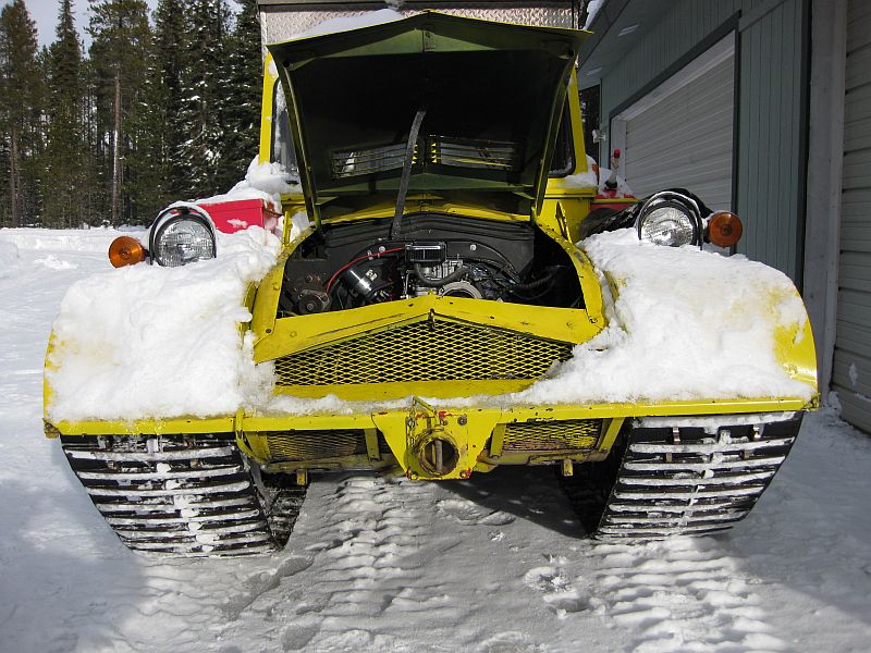

Looks like you could use the "3 silver dollar size holes" under your extractor.
Would that be in addition to the several hockey-puck sized holes (red arrows) I have in there now :brows:? I took your advice and actually punched those holes last winter hoping that it would result in the needed cooling after I installed the new engine. In my case, it wasn't enough but undoubtedly helped cool the engine compartment. These pics were taken with the engine pan removed, but I also put heat-reflecting cloth on the bottom side of it. My hope was to reflect some of the header heat out through the large holes in the belly pan. This undoubtedly helped an incremental amount, but no siginificant improvement was seen until I did the cooler mod.

I see your "Silver dollars" now! On one of our Non-Stock ST4's, (Ron Hoffman, lives near Yakima, and runs a 1741 in a 63' ST4), he got a full 35 degree temp drop out of the addition of those holes! Suprising something that simple could have that pronounced an effect.>
We used those cheap automotive Inside/Outsied thermometers, and landed the thermistor/thermocouple ends of several on different spots around the engine compartment. One of the most obvious problems was how hot the fuel line got and that it wanted to boil fuel in the see-thru fuel filter. All ST4's came from the factory with a dip stick type oil temperature sender and matching guage as standard equipment(VDO, all still available). Since VW's didn't come with this feature standard, it suggest that oil temperature WAS a consideration, right from Westermaskiner. I recomend pressure and temperature guages as well as a standard Idiot pressure light.

You bring up a good point about the "holes." It's the 3rd leg of keeping the VW engine running reliably and cool - engine compartment temperature. This is something that Westeraskmaskiner (sp?) didn't adapt to nearly as well as VW. In the Bug, the engine pan seals the base of the engine compartment and keeps much of the waste heat out. There are too many places in the ST engine compartment, notably around the chains and sprockets, where waste heat leaks back in. Some ST4 and ST4B's have an air horn with an auxilliary fan to pull cool air into the engine compartment. I thought about reversing the fan blade so that it would pull hot air out, of course ducting the hot air away from the clean air intake.
I should be more clear about the effect of the holes. While they didn't effect CHT in any appreciable way, which is more directly related to combustion temp and intake air temp, I have noticed that my engine compartment is cooler for sure, even cooler than the stock 1600cc configuration without the holes. I haven't actually measured the temp, but I can touch stuff in there now without fear of burning my fingers. Also absent are much of the plinking and tinking sounds of hot metal cooling when I shut down. Add the holes!
