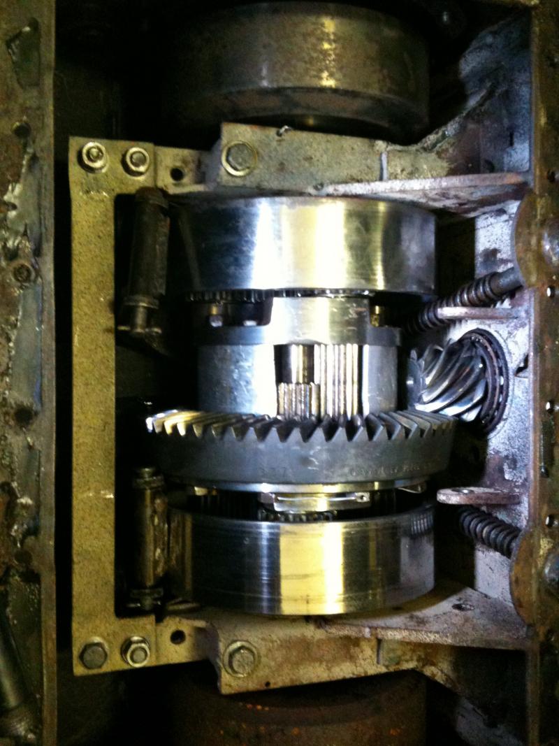

Berg,
Not sure what pictures you need but these three show the differential out of the case and it assembled in the case. If you need a parts schematic let me know and I'll send you one.

I’m not sure what the correct terminology of the differential would be. There is a planetary set on either end along with the gears in the interior of the differential that function similar to spider gears in an automotive application.
