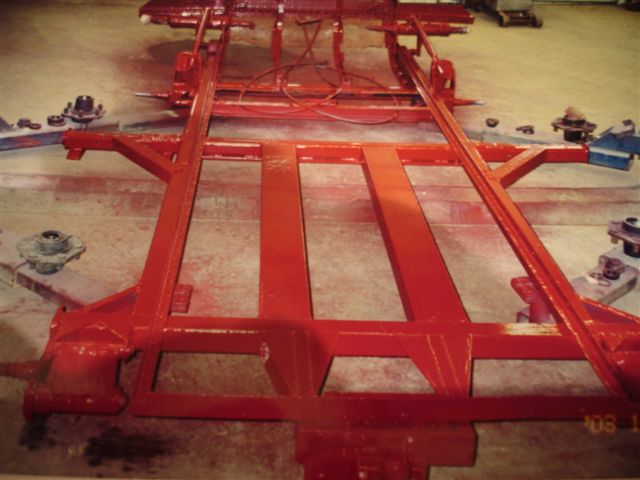

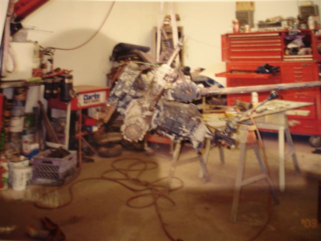

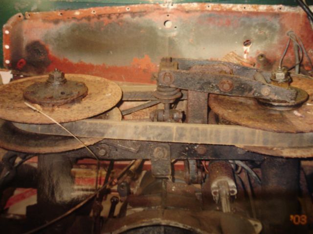

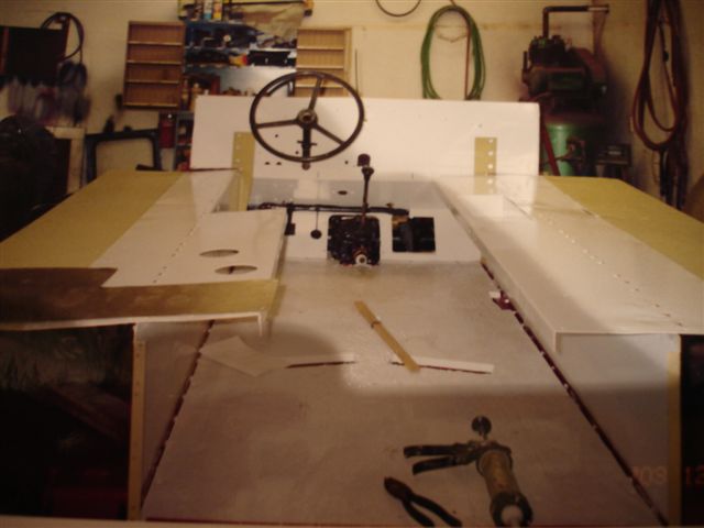

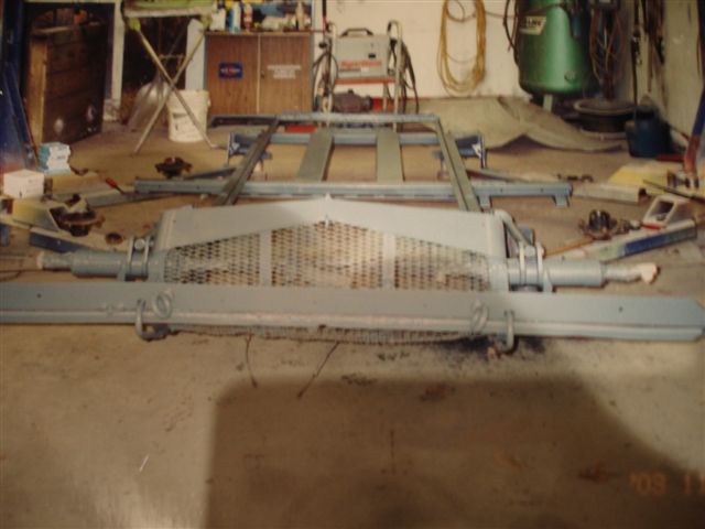

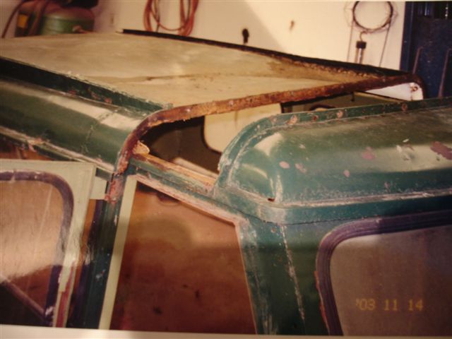

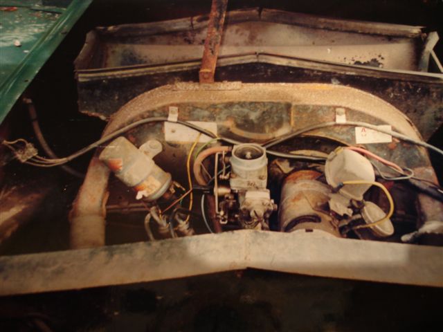

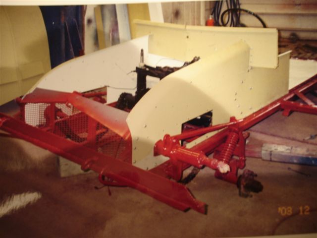

Well it all started with a $1.00 allowance and a .50 cent match box - lost in space ( the 1960's tv. show helped as well). they had this cool tracked vehicle which i always wanted to drive. I thought I was the new will robinson - in liue of robertson ... ha! funny but prob. not far from the truth . our toys do get bigger...
purchased the 1964 st4 in midlands- england and had it trucked to southhampton and then shipped to new jersey and trucked to cold spring new york .. sat there for two weeks while family and friends attempted to fig. out what crazy project i have attempted . wife took one step out the front door and went in without a word.. but then again they didn't own a .50 cent snow trac. when we started I didn't know which of my snow trac's was worth the .50 cents . its now been almost 3 years of constant building , most parts including the roof and fenders and interior parts have all been re-fabricated out of high end industrial aircraft alum. cleats are custom made stainless being laser cut / drilled by IBM . but they don't know it.... thanks to christor and his site i have replaced every bearing and part possible ,and obtained info from mr mezel in north pole ak. why did i replace everything well ....... becouse it sure did need it... look at it .. poor looking thing, only my three sisters are uglier :boobies: :moon: Gordon Robertson more later....1/30/06

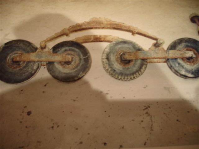

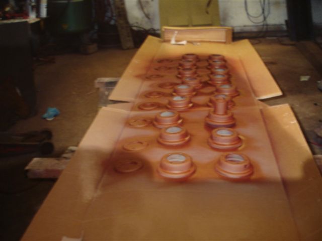

we were able to locate new bearings, wheels , belts, tracks , decals and oem tools from alaska . we found tires in china , we had custom cushins made ... ooops sorry the photos are not there yet.. as i noted prior all the cleats where stainless also mfg by IBM who would of know... computers and snow tracs

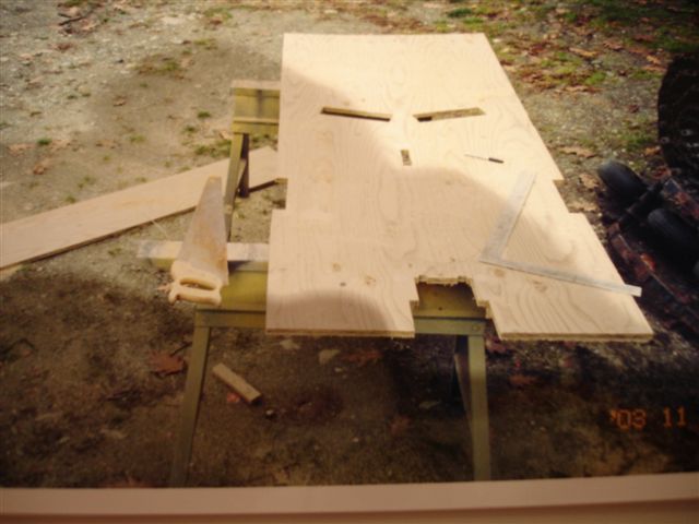

going through my records and invoices i have found a bunch of interesting materials and some part sorces that may be of some interest .. i will scan same on monday and attempt to attach . also have spec.s on cleats which will save a fabricator tons of time... and allow you to alter to your taste.....

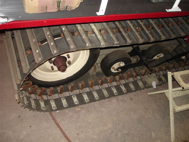

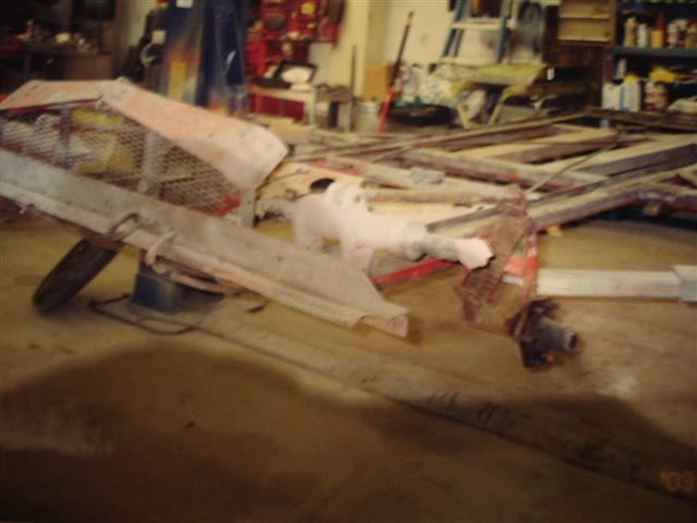

talking about cleats , when these things came apart as you can see , i never thought I would get them back in place... I can't tell you how heavy all these items where , new stainless was not that much more in weight. but when you have all this stuff in the back of a f150 wow.... the power steering has power steering..... grr...
we were luck and scored new belting in alaska . and everything lined right up but dragging it around was a chore.... grr

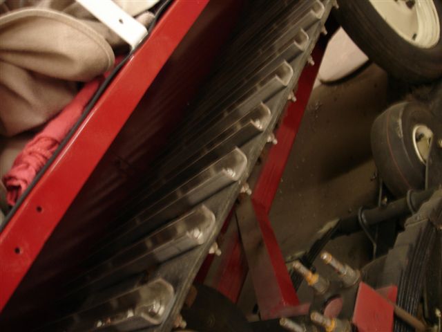

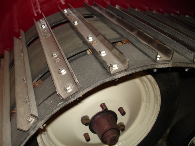

Gordon, you & I have discussed your CLEATS via email, but I thought it might be interest to other folks.
Your cleats are stainless steel and, to my eye very aggressive. Now while I love the idea of stainless steel, I wonder if your Snow Trac will not gain so much traction from those cleats that you might actually drive off your tracks if they get 'to good' of a grip into something.
Now I'll admit I drive mine on grass so grip is an issue. Grass does not slip like snow, sand, or ice or gravel. I've almost driven right off of my right track a few times. So I am very cautious on grass when turning.
My ST4 uses the standard shape track cleat, which is tapered. PHOTO BELOW
Perhaps someone with more Snow Trac experience can chip in with some real life experiences? Villi, Bjorn, Dan, Jock, etc . . . can you folks help us out? Is "too much grip" a bad thing in some select conditions?

Well Bob,
I can tell you the first thing I was told by the guy I bought my Snow Master from was not to try and turn on grass. He explained how he walked right out from one of his tracks! Mine are about 12" wider but thats alot more traction. Maybe like that with those great looking stainless cleats Gordon has. But if you look there are two extra holes on each of his cleats. If I was going to be driving on grass or a road I would simply bolt some doug fir 2x2 trimed to fit and have some fun. I bet a 2x4x8 stud could be trimed up on a table saw and yeild quite a few wooden cleats. You would have to cut a recess groove for the drive sprocket which should be easy. If you wanted something that would last longer go with oak or some other hardwood. Pricey though.

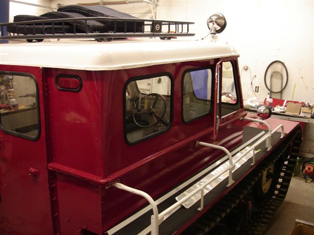

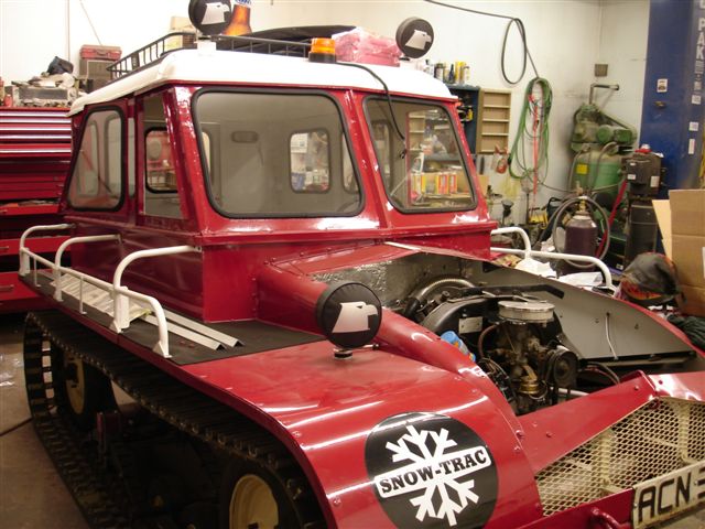

Gordon, just curious, but with the roof rack mounted on your roof the way you have it up there, can you open the sun roof for fresh air?

your correct bob , no sun roof ... just don't need a tan.... since all the body panels etc. are new fabrication no sun roof.... the real story is my wife likes to hang out limo sun roofs so i thought i would limit her champain bottle tossing abilities....
i was also planning on maintaining a seperate full time roof basket... so no need for the extra costs...or the possibility of leaks... bob has not yet posted any photos of my lights but we went to rear flush lcd. lights on the tail and custom stainless for the front and roof... still thinging about a teardrop... but need to find one first..... cushins located on the roof are not for roof touring but for the interior.... custom black sun-brella with closed cell foam... .. you could sleep on these ... however , wife continues to remind me of this.... we have now purchase a gps. and a dash mount. this will attach to a ibm lap top with will also be mounted and will connect directly to gps for large viewing .... the interior has been given new custom hand rails - grabs for each side of the bench seating ... interior navication lights have been added for night vision . " go to red boys..." something from my sailing days..... we have also mounted night vision monocular ( sorry about the spelling ) on that one ..... roof rack will gain newly purchased ax & shovel mounts being painted tonight.... still looking for huge skis to design a tag behind camping trailer with pop roof. type of roof tents you see on landrovers... talk later.... grr

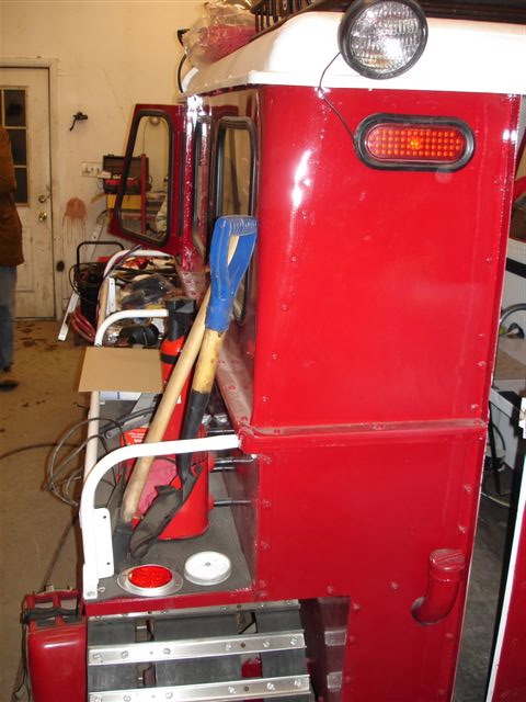

well photos are better then words , this dust covered st4 is closer to getting out the door , i will attempt to provide more current photos of interior and some extra's now being installed... i am sure you all will get a kick out of it. i see that bob has posted some photos of the newly welded basket for skis and snow shoe's hopefully i will not need to use either and will just delivering friends to far off lands... i found that the lcd lights are brighter less of a drain on the elec. system and bright as hell.... plus add that sleek look ... i am sure if they where mfg. st4's today that would be the way to go....
still looking for large skis should anyone have any ideas for a trailer .... hey this projects coming to an end need something else to work on... grr

Gordon,
The Highway guard rail will simply out perform anything else premade! The trailer will track right behind you even if your crabin a side slope. On side hilss it will track beautifully! Not bad for Highway Guard rail. You will also want a pintle hitch. NOT THE BALL TYPE! At least here we have alot of hills and slopes that will go far beyond the flex of a ball hitch. Hope this helps.
:beer: (this idea was given to me buy a friend who builds snowcat trailers that sell for 15K!)

Hi Gordon and Bob,
I'm so glad I found this forum today! Looking at your frame-up restoration, I thought I had replaced a ton of bolts. If I never see another Phillips-head bolt with a lock nut again, it'll be too soon. "Bolt, meet Mr. Angle Grinder."
About cleats.. the original cleats are made of a spring steel, which is both strong and resilient. Honestly not sure how your stainless measures up in comparison. I'm sure it depends on the alloy. They sure look good though! Please share how they hold up after they've had some break-in time.
I'll also be building some new cleats this spring. My plan is to use 8120 square tube stock(for the round edges), attach a jig to cut the taper, and go at it with my new plasma cutter. I have one cleat that looks as though it was zinc plated, that is holding up nicely, so I may be purchasing a home plating kit from Eastwood.
Too much grip? When I bought my ST-4, it came with 2" paddles welded to every other cleat. My experience was to either drive out of the track(now I carry a high-lift jack) , or worse, one of the drive cogs would skip, causing premature wear and rounding of the brass teeth.. Both problems have disappeared since I cut off the paddles and I'm back to tapered cleats.
As far as the sled-trailer, the guard rail is an interesting idea for skis. If I can come up with some interesting ideas, I'm going to build one out of aluminum this summer. Being that I have to drive stretches of dry highway on occasion, and having seen only one sled trailer ever, I'm going to steal an idea from this one found on Tim Wafer's page and use tires as well as skis.
