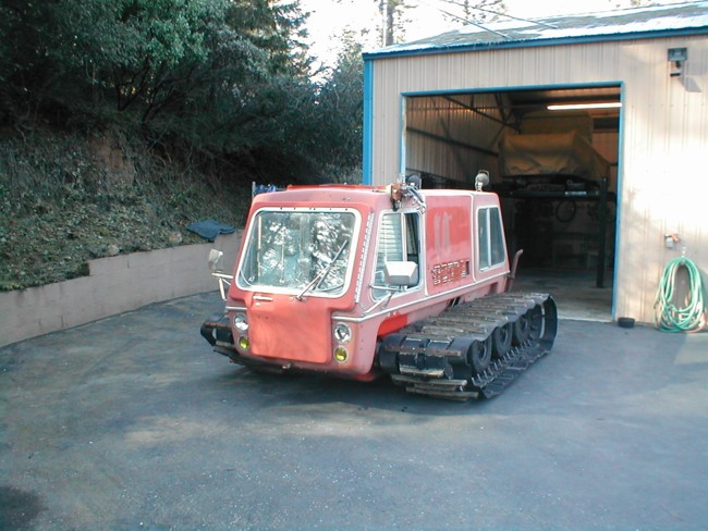

Ok Snow trac owners ! I got my head out of my A## . Boy was ever stuck. Anyway got the first pictures taken of the KT7 before restoration . I got off all the extra hyd. lines and valves that the snow grooming club had added . I now have enough old hyd lines to circle the world !
Tomorrow the center roof section comes off and then the fun begins !!! Oh Boy !!!!!
The engine runs strong and I see no reason to pull it . Going to take it as far as I can before removing tracks .

Al, i like the shape of this particular Kristi!:thumb: It looks better than the early ones you put on the forum. I didn't know there was a choice! How many Kristi variants are there, and when was the company last trading?
Nice picture Al. :applause:

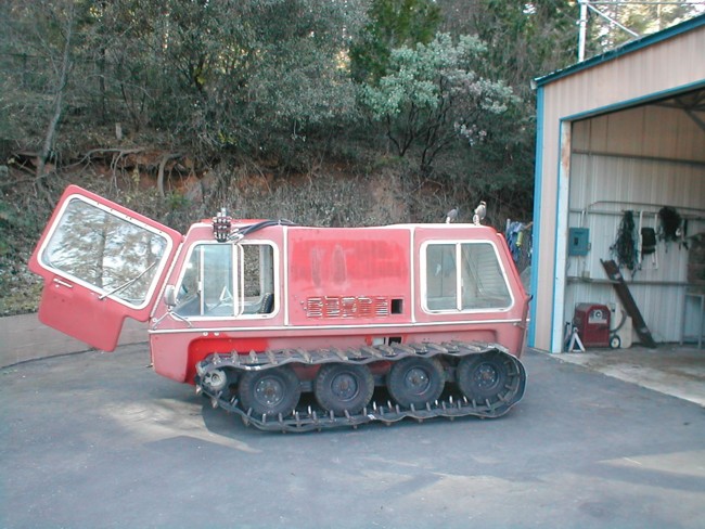

Hi Tommo ,
This model never went into production . There were 4 KT7 proto types made from what I have been told . #1 was a steel body and to heavy . #2,#3, seem to be lost and no ones no where . This is #4 and the only one I know of . It is powered by a 4cyl Ford and is all hydrostatic drive .The body is hand laid fiberglass
Kristi started out with the KT2 ,then a KT3 ,then a KT4 , then a proto type KWT was made and is sitting in a container in Denver, Co . It looks like a 1964 chevy pickup on tracks . It has two drive systems and can have the tracks removed and run down the road in summer . I have put in a standing offer to buy it .
Last came the best of all . A "KT7" which is in the picture . Kristi put every idea they had learned from the prior models into the KT7 .It never made production as the company owner was killed and so died the company .This would have been about 1972 ,I believe .
It was a small company and you could pretty much order any style body design you wanted . Hope this information helps . There are Kristi's in Europe ,but the trouble is finding one . Over here in the states they come up quite often for sale . On the 28th of this month ,there is a KT2 going to auction in Canada .
Allen

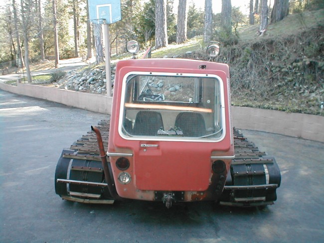

Here are 3 more photos. They are taken from the rear of the unit . The last picture shows the rear seats . They face backwards . The center area has a storage shelf/engine cover (48"x48") which is not installed and is in the shop. Kristi has it listed as a 6 passenger unit ,but I am unsure how or where the other two seats were to be installed ?????

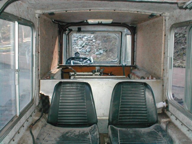

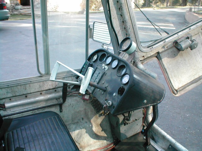

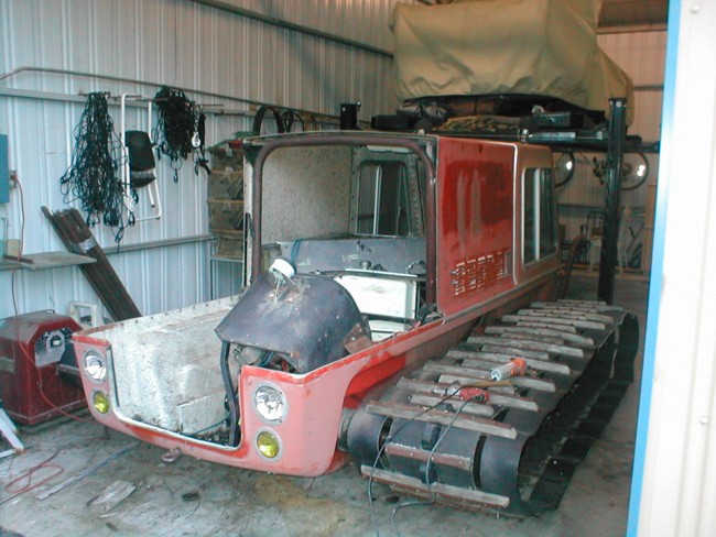

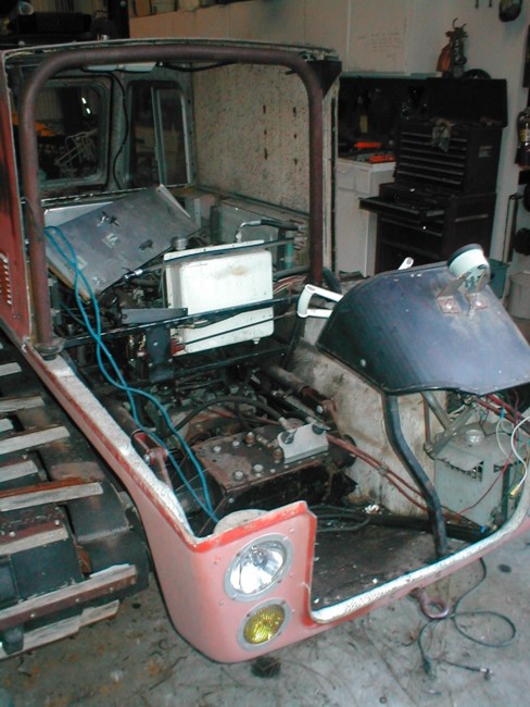

Today I removed the front seats , entry door, front side windows and front cab section . I now know why it is called a proto type . Once I got inspection covers off, you could see where different components had ,at one time been installed . There are items tack welded in place and then bolted down ,like the builders were trying different placement before drilling holes.
The center roof section is completely rotted and will need replacment . I hope to find a large piece of polished Aluminium ,so I can have it bent into a one piece cover and set it up with quick disconnect fasters ,so the center section can be removed easily to access the engine compartment .
I am now sure that the linkage steering cables are not orginal or were a temporary fix as they are too short for proper routing.
Once I get the added hydraulic tank removed (the big white tank in the last picture ) the engine compartment should be much easier to navigate .
The wiring system ,while repaired and working is a complete mess and will get replaced with a one piece loom . Engine choke and throttle control cables will be moved from engine firewall to the main operator control panel .
The cab heater has been added under the operators feet and it will be moved to the center section to vent heat front and rear and to allow more leg room for the operator .
Going to head to the car dismantler to see if I can find a small van seat to replace the two buckets in front . Seems like this would work better than the present system .

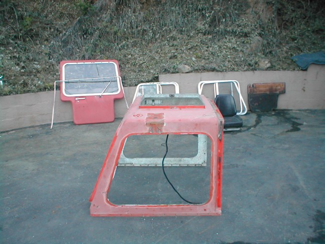

Today the rear cab section came off as well as the seats , gas tank and windows . I am glad I am going all the way through this as the gas tank was just sitting in a support tray under the seats . No hold down brackets of any kind ! Geez!
Found about 1/4 inch of muck and grease on the floor after I got everything pulled . I doubt if the engine oil has ever been changed in the motor . Kristi did not leave any way to get to the oil plug !!! All kinds of old hoses and tools laying down underneath the engine ! I am going to rig up some kind of a oil drain system with a remote shut off valve.
The added metal supports for towing snow grooming implements is cracked in half .
Hydraulic filter is going to get relocated to clean up the engine compartment.
I found out today the big white hydraulic tank that sits on top of the engine is part of the orginal system . Good Grief !!! It looks like it belongs in a "Maytag wash machine" more than a snow cat . Need to see if I can relocate that puppy . The way it is there is absolutley no way to drain Hydraulic oil without giving engine a bath . Maybe this is where all the oil crap in the bottom came from !
I am beginning to think electrical wiring was redone at one time . Wires go in every direction with no thought to what they are crossing .
Still having a good time ! Here are two more pictures with the rear section removed .

Ok!!! The upper half of the cab is all off . HAPPY DAYS!!!!:coolshade
The radiator which is out of a 1965 ford mustang looks like it was used to store grease in the fins . What a mess ! No Way it could have cooled like that .The Radiator brackets are broke and the support frame was never welded in place ! The only thing holding the radiator from going through the fan was the air intake box ! I am going to look at some aftermarket cooling fans to replace the engine driven fan that is now in place . I once owned a Radiator shop so now all that expertize going to be put to use .
Starting to get a pretty good pile of crap and old parts !!!
On a good note I found a very small access floor plate to get to the engine oil plug . That makes me feel better .
Grease is everywhere and tomorrow it should get pulled out and given a good degreasing and a pressure wash .

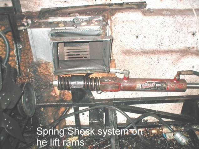

The track shock system is pretty slick . The lift rams are mounted on coil springs to help ease any sudden force put on the rams .
