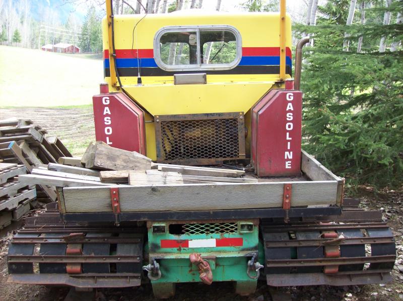

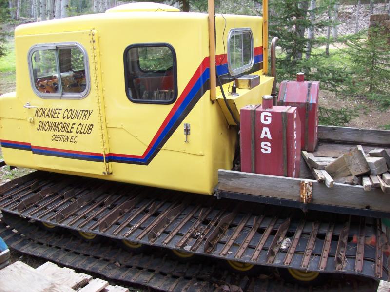

I found a Spider, been sitting for many years. looks to be a bit smaller that the one in the pic, two man cab. how do these things steer with just one lever? you dont have to stop to turn? any idea what it would take to retro one for true independant hydrostatic control of the tracks? The stock motor directly powers the hydro pump that delivers the oil to the two motors, but with the cross shaped control in the pic, how does it steer whle moving forward? I'd love to talk shop on this before I too will have the wife mad at me! i'f Im going to be living in it I want to buy the right rig!
the plan would be to install a modern EFI engine to run better at high altiudes, ~10,000 here in Colorado...may be a challenge to power the pump...thus my need to gather some details. Swixb at comcast dot net. If I delay someone else will snipe it.
that looks like a nice little rig never seen a nodwell product for snow only looks to have monster tracks with doubble road wheels like a muskeg what does the thing weigh
2500 pounds? cannot be too heavy, fiberglass cab & bed. you can see the large chain drive sprockets on the axels. looks smaller than the other spider on this string. 6 wheels. no pic of the interior on this unit. been sitting for 10+ years, prob 15+. missing one track, wondering how hard it would be to buy/fab new grousers? or retrofit with Imp/Spyte drive hubs? but then I'll need two sets....
that one has single row road wheels looks like a good starter project i would check with boggie about a set of grousers and guides and keep the same axles you can buy belt the plus side of nodwells is that they are built like a brick $hit house thiokol spindles are kindof weak 2500 pounds is pretty good puts it in the same weight class as a snow trac and alot easyer to get in and out of
any idea how the hydrostatic system might work? true independant track control? like a "modern" rig? why did this tech not catch on? when was this rig made? late 60's? Thiokol seems like they dominated the market. 2500# is just a guess. Yes this would be my first snowcat, I did rebuild a Muskeg a long time ago, talk about a brick house...7000#, not a snow rig, but could go on tundra all day...the Thiokols had a poor reputation as they walked out of thier tracks when the going got tuff.
did find a Kristi for 3500...met a guy that put a turbo Audi engine in his VW Van, bolted right up...had a bug for my first car...light yes, reliable well, not so much.
Thinking 150-200 hp/tq would make this purr. or blow it up? ha. do not have a feel for what loss will be had with hydro vs. direct like a skid steer unit.
krusty for 3500 Big Al must be selling his my understanding is about a 30 % loss when using hydraulics to replace gears i'm guessing less power loss in a turn than brake steer some of the newer hydro static systems may be more efficent.
I was looking at that same snowcat, guy said someone was coming to buy it. The yellow Spyder I had was a good cat, the steering is a little hard to get use to at first but fairly simple. The cross pattern is a diamond on top the same as the bottom, the two slots in the middle are for turning on a dime(pull all the way to the left and both tracks will turn in opposite directions turning the cat to the left, same as the right). The diamonds are for forward and reverse, the more you move the joy stick into the diamond(get your minds out of the gutter kids) the faster the cat will go and of corse moving the stick to the left or right in the diamond will turn the cat while moving forward or backward. These cats were built in Calgary Alberta Canada, I was told they were built in the back using Foremost parts, they discontinued the smaller cats and went towards the very large industrial cats. The cat in the picture is a 1971. Parts for these cats are fairly easy to find at places like Princess Auto(large discount store in Canada). I would buy it
