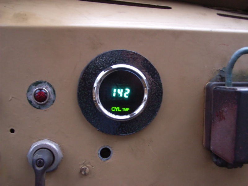

Cylinder head temperature is a concern since mine is a large bore engine and I retained the old-style fan shroud and oil cooler.One of the most critical additions I made is a Dakota Digital cylinder head temp gauge. Dakota's gauge is the only affordable CHT gauge/sender I could find that gives an accurate reading that's corrected for ambient temperature. Tested it in boiling water and it is spot on. I placed the thermocouple ring under the spark plug for the #3 cylinder because that's the jug that the oil cooler dumps most of the hot air on. Despite low operating oil temps (~175' F max), the #3 head can get awful hot when going up a grade in 4th gear, but the gauge tells you when you need to back off the throttle a bit or downshift.

Next is a shot of the Dakota Digital cht gauge. I was told that cylinder head temperature is largely independent of outside air temperature and I am amazed to find that to be true so far. So far I've run the engine from a low of -14' up to +17' F and haven't noticed any real difference in head temperature. Engine oil temperature is a different story, it seems to be very much affected by air temp.

I was told that cylinder head temperature is largely independent of outside air temperature and I am amazed to find that to be true so far. Engine oil temperature is a different story, it seems to be very much affected by air temp.
Correct on all counts! Number 3 is always the problem child whether it's on rail buggies, Beetles, (or ST's apparently), due to the doghouse oil cooler and the way the air flows within the shroud. It will be affected by warmer climates but probably won't get run hard in those conditions so you won't really notice it. On my buggies I always ran a remote cooler instead of the doghouse to reduce the tendency to overheat it. There is also an aftermarket shroud that addresses the problem but I honestly don't remember if they come in a version that uses the stock oil cooler. The oil cooler is subjected to direct cooling using ambient temp. air and therefore air temp will cause marked differences in oil temperature.

That looks like a very nice job on the engine! WHich Dakota Digital gauge did you use?
Thanks couchloafer. I used the odyssey series gauge. The sender ring fits under the spark plug and takes the place of the copper crush ring. The I.D. of the sender ring is 1/2" but the spark plug thread O.D. is 14 mm (= 0.55"+) so you'll need to enlarge the I.D. of the sender ring a small amount. The ring is soft so be careful. I chucked a chainsaw file in a cordless drill and slowly filed away the needed amount.
I found it was impossible for the plug and the tail of the sender ring to fit into the spark plug recess together, even with the tail bent up parallel to the axis of the plug. Using a 3/8" bit, I drilled a pocket on the edge of the spark plug recess for the tail to sit in. This will also keep the sender ring from spinning and being ruined (I hope) when the spark plug is removed/installed. Anyway, senders are cheap, 9 or 10 bucks I recall, so get a couple. I got an extra ring and thought about installing the it on #2 and using a toggle switch to display the output from #2 and #3. Much cheaper than buying another gauge.
Thanks for the information mtmogs! I am placing my order tonight!
Good Luck! Here's a link to a technical article on installing CHT senders that might be of some help:
http://www.germansupply.com/xcart/customer/home.php?gspage=customer/main/tech/cht/cht_install.tpl
Now that you'll have an accurate CHT...the $1MM question is "How hot is too hot?" I can't find a definite consensus from searching the web. Some say 400' F, some say if you reach 450' then the exhaust valve seats fall out of the head and you're done, some say they cruise all day (buses) at 425'. I read that the heads in the flat-4 Corvairs ran in excess of 500'. Maybe Lyndon or Willie can chime in here. For my purposes, I will keep it below 400' and try to maintain around 350' ish.
If I have a problem keeping a lid on that range, then I will switch to the external doghouse style cooler and shroud that removes the oil cooler from the fan shroud. The general operating condition I see on my new engine is that the oil temp is a bit on the cool side whereas #3 CHT is a bit high. The stock oil cooler is doing a great job of cooling the oil, it's just that it's dumping all the waste heat on the #3 head. Removing the oil cooler from the fan housing should at least help reduce the CHT on #3. Of course I'll have to modify the snow trac intake horn to accommodate the newer style cooler.
Another option would be to leave the old-style cooler/shroud in place to maintain proper airflow/pressure in the shroud and add a full-flow aftermarket cooler and fan (with a thermostat to raise oil temp) to take some of the waste heat off of #3. Anyway, it seems that the CHT is dropping a few degrees every time I run it (as the engine breaks in) so I'm guessing I won't have to make any modifications :applause: .
Cheers - Paul

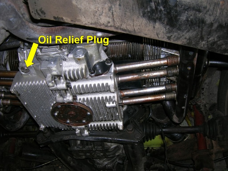

... Also added a new VDO oil temp gauge and sender (mounted in the front oil relief plug), ...

Can you please provide more info on how you setup the oil temp sender and gauge? I have mine hooked up off of the oil pressure sender tee and it does not seem to work real well. Is there an adapter or busing for the front oil relief plug to adapt the sender there? Some pics or part numbers of that would be most imformative. :thumb:

Here's the temp sender I got for a VDO electric pressure gauge, it takes the place of the and oil relief plug (can be either the front or rear if you have a newer dual relief case).
http://www2.cip1.com/ProductDetails.asp?ProductCode=VDO-323-064
Anyway, as you look at the underside of the engine case, you'll see 1 or 2 large (quarter-sized) slot-head screws tapped into the bottom of the case. (See pic I copped from the Samba and labeled) The one in the front (for an ST4, rear for a bug) holds the oil pressure relief valve, the one toward the flywheel(if you have 2) is the pressure control valve. I removed the screw for the pressure relief valve and replaced it with the sender. A spring will force against the screw and will want to send it flying a bit so be careful when you take it out. A spring and a small cylindrical thing (valve) that rides on top of the spring should come out. You don't have to drain your oil beforehand, but prepare to lose half a cup or so through the hole. Just replace the slot-head plug with the sender, route a wire to it and you're good to go. Here's the gauge I got to go with it:
http://www2.cip1.com/ProductDetails.asp?ProductCode=VDO-310-709

I finally got around to installing the Cylinder Head Temp Gauge as I have no snow to operate in County wont issue groomed trail stickers to Snow Cats any more.....another story.......Can you give me an update on what your gauge has been running for temp since you installed the aux oil cooler?
i went to a local snowmachine shop and got my cht gauge about 100 bucks with a sender for a 14mm plug works great the product came from western power sports an after market parts supplyer
No, very little snow here. This winter has been dismal with record low snowpack and record high temps. I'm hoping we get dumped on in March or else the coming fire season could be nasty. We have less than 2' here at the house and maybe 3' or less at the cabin. No powder anywhere at lower elevations so we even took the 8x8 Argo with tracks up to the cabin the other day. The Argo is a fun little vehicle, but it is so slow compared to the snow-trac.
The CHT on #3 runs noticeably cooler than it did before I moved the oil cooler. I'd have to say in general that it runs 20º-30º F cooler than it did before. I can still knock it up above 400º if I'm going up a long steep grade in soft snow while pushing it in 3rd, so 30º means a big difference under these conditions. What sort of temps are you seeing? Just cruising around without trying to whip her to much I see an operating temp range of ~310º-340º. Oil temps never seem to get too much warmer than 190º or so, but that's thermostatically limited by the external cooler and fan.

Don, what brand of gauge are you using? One thing to keep in mind is that most of the cheaper gauges/senders like VDO are *not* compensated for ambient temperature so you get an inaccurate reading. As I recall, the VDO CHT gauges are calibrated for an engine compartment temp of around 70º F. The rub of it is that if your engine compartment warms to 120º, then your cht will be reading 50º too low. That's not a big deal if you're not running hot, but what about if you see 400º on your gauge? That will mean barbecue time for your exhaust valve seats if you keep it up for too long. Just something to keep in mind.
the gauge is a thermo coupled gauge for a snowmachine it was cheaper but looks identacal to the ones used on aircraft engines i will poste some pics later i'm in the process of an engine re build to corect excessive endplay also found a missing wrist pin clip on #3 cylinder
