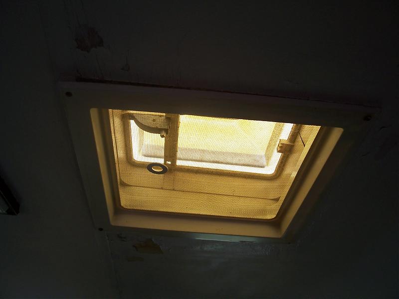

Yesterday I replaced the front vent. As you can see in the pics there was a crack in the actual vent housing. Think that was letting a little bit of water in? As you can see from the pics there is some signs of water. The wood is a little bit dark, but it is good and solid. I poked it with a screwdriver and the most I could get was a little dent (whew, was I glad - not sure how I would've fixed it.)

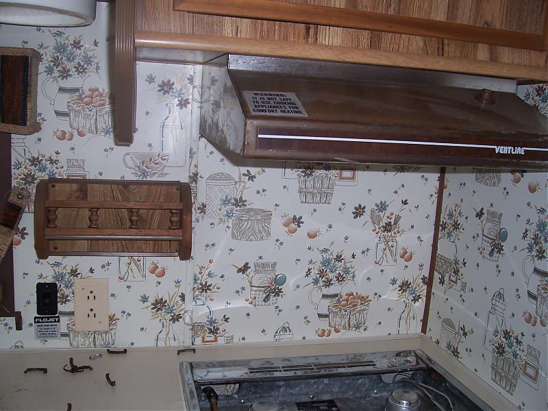

As you can see in the pic the current range hood is pretty rusted. We were going to paint it with a high temp paint, but we couldn't find white. Only black. Looking on Ebay we found a new range hood for $20 with $12 shipping. So for that price we decided it wasn't worth the effort.

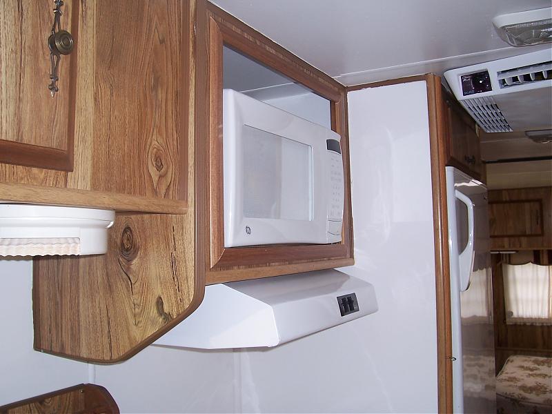

We also didn't like the little microwave on the counter. We found one at Lowes for $80 that will fit in the one cabinet - where it would've have been had my Aunt opted for one when they bought it.

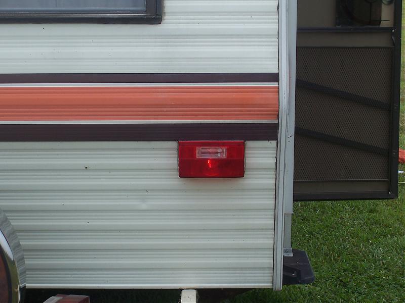

The other thing I worked on was exterior lights. I replaced the plug that goes in the truck. Also replaced the taillights. I now have brake lights/turn signals and back-up lights - but no running lights. I've removed all of the front clearance lights and the outboard rear and none of them have current. I've got power coming from the truck but none at any of the lights. I think I've got a broken wire somewhere. Just not sure how to go about finding it yet.......

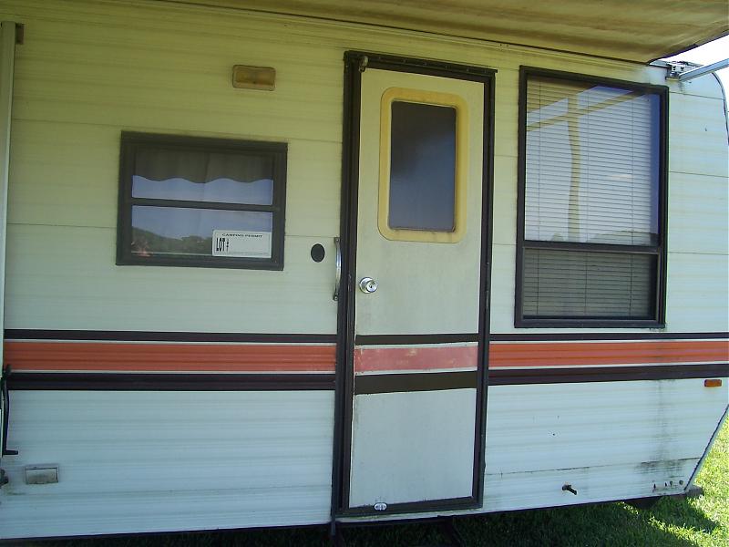

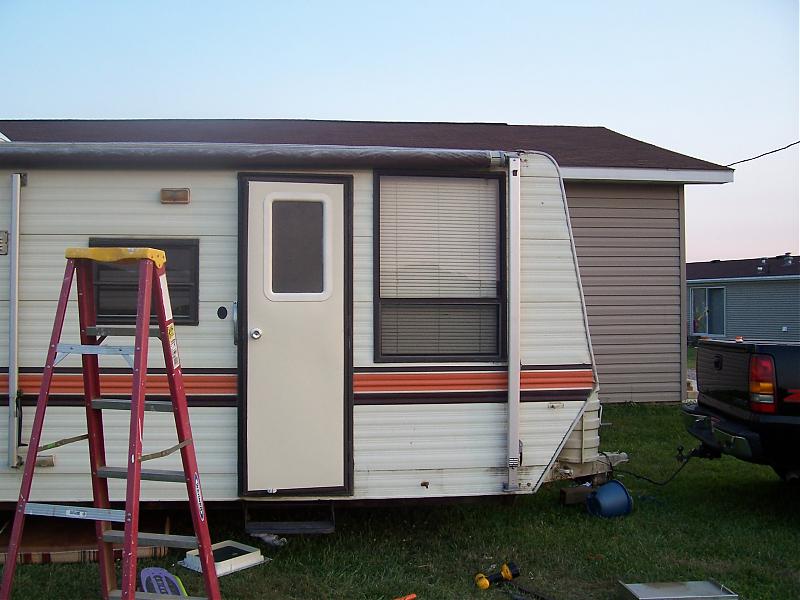

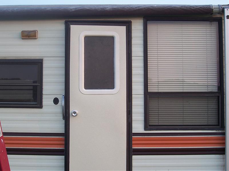

Finally made it home so that I can post pics of the door. First pic is the door before we started. The rest of the pics are after. I ended reskinning both sides. I was originally only going to do the one. I'm pretty happy with how it turned out. I will probably run a small bed of silicone along the frame of the door to help keep water out even though it is made out of treated lumber now - don't want ice getting in there and pushing the new skin out.
Didn't have much time tonight (had a consulting job after work and then had to stop by Mom & Dads and look at there truck - broken brake lines) but I did get to mess with the lights a little more. Took the last 3 rear inboard lights out. Still a no go. I then rigged up a pig tail from the truck to the left front marker light. I then have good juice and good ground going to all lights. I think this tells me there has to be a bad wire right at the front of the trailer. There are some screws at the bottom of the sheet metal. I think I'm going to take those out and see which way the wire goes and see if I can pull a new one through.:drink: :toilet:

The door looks good. Good luck with the lights. Sounds like you have a handle on it.
Nice job on the door!

First a before picture of the kitchen. Next a couple of pics of what it looks like now. I'm pretty happy with how it turned out - except for all of the tools on the counter top.:yum: Still waiting on a new faucet. I was thinking it went throught the sink so I made sure I bought a 4" like was there. After doing the new counter top the faucet goes through it, I could have bought anything and put in. Oh well, live and learn. It should be here early this week. BTW, I've got a little piece of lumber behind that moulding and in front of the "legs" of the microwave to keep it in there. I also put a piece of OSB on each side to keep it from going back and forth. It might move a little, but not much.

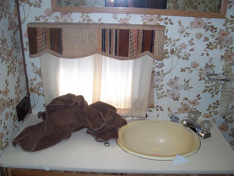

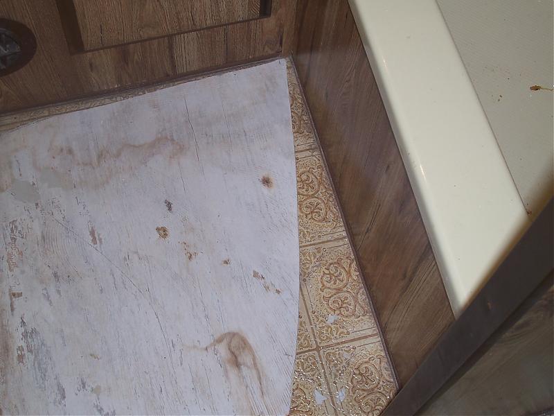

We've also made some progress in the bathroom. First a couple of before pics.

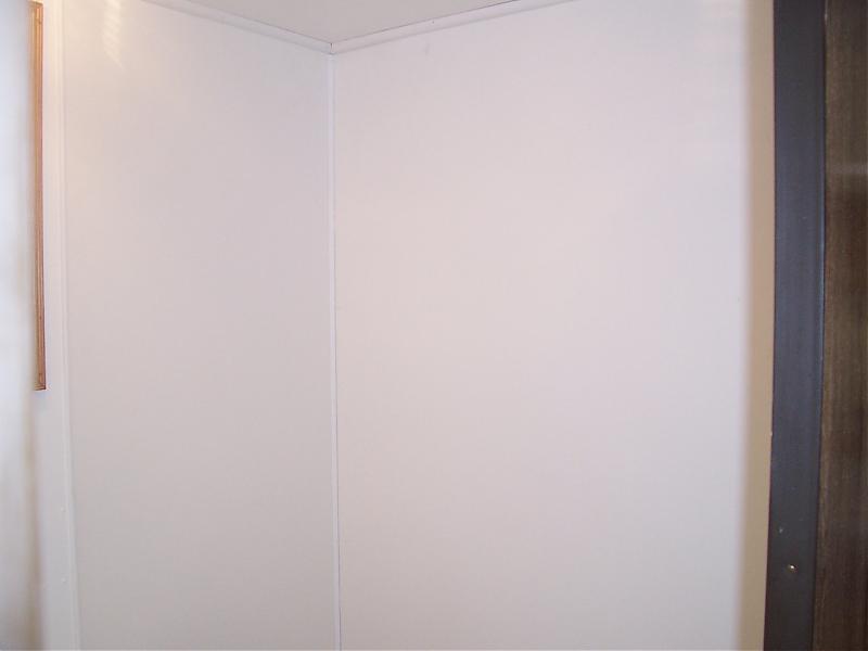

We've painted the walls and then where over the tub we put in a new surround. I've overlapped it around the top of the tub, but I don't care for how it looks so I need something to cover it yet. I might get some PVC trim and glue it in place.

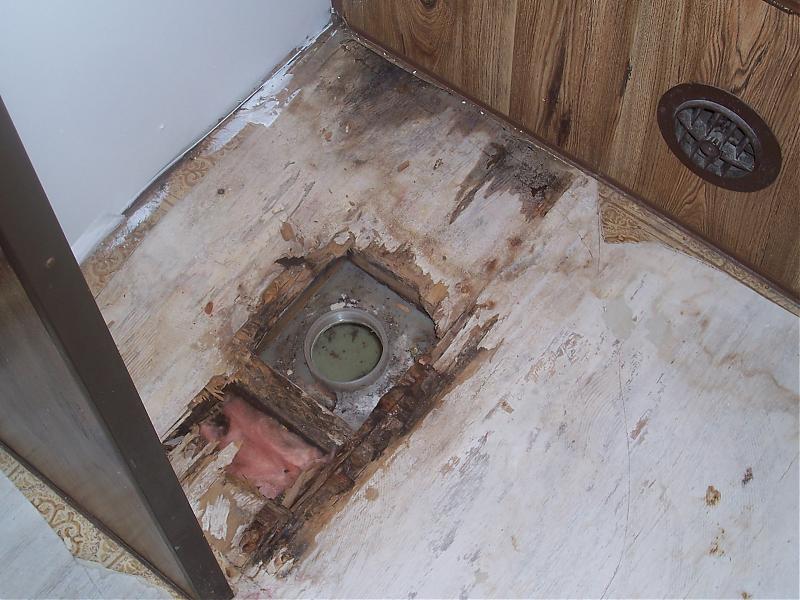

Now the bad news. I knew the floor was squishy under the toilet. But didn't know how bad until I started removing the linoleum. As you can see in the pic it was pretty bad. I wasn't really sure how to fix it since like Jerry said earlier the floor is put down and then everything is put in. We'll know that I probably couldn't go that far and fix it right, I got a piece of 3/4" B/C plywood and covered the whole floor in the bathroom. I was able to get some good solid flooring over by the tub and use screws there. I was then able to put in a new closet flange. I then put down some of the self stick floor tile. It only took 7 pieces to the the whole bathroom. I wanted to get some pictures but I forgot - I'll get some tomorrow. I don't want a little "step" to get up into the bathroom. Turns out a 7/16" sheet of OSB with the snaplock hardwood floor = a piece of 23/32" plywood. I'll then just cover the transition with one of the little metal strips and I think we'll be good to go. If this were a house or even something we planned on keeping forever I wouldn't have done it this way. But we plan on using it for a year or two and then we either like camping and we get one with a couple of slides or we don't like camping a cut our loses. Either way I with the leaks stopped I think the new plywood will last a long time.

I got my lights working. I had a bad wire in the harness so I replaced the wiring the whole distance.
I still had to tinker with the the back lights to get a good ground to the frame.
That was one reason why I went with the LCD clearance lights. They have a separate ground wire on them. Makes them a piece of cake to hook up to the camper that has a ground wire running everywhere. I had originally bought lights that grounded through the mounting screw. Couldn't figure out an easy way to do that one, was planning on having to put an eye on a wire to form a ground wire.

Next pic is of the new tub surround and where it meets the tub. I'm not happy about this, but I haven't quite figured out what to do about it yet. One thing tha really makes it look bad is that nothing is square in a camper or at least the ones I've worked on.

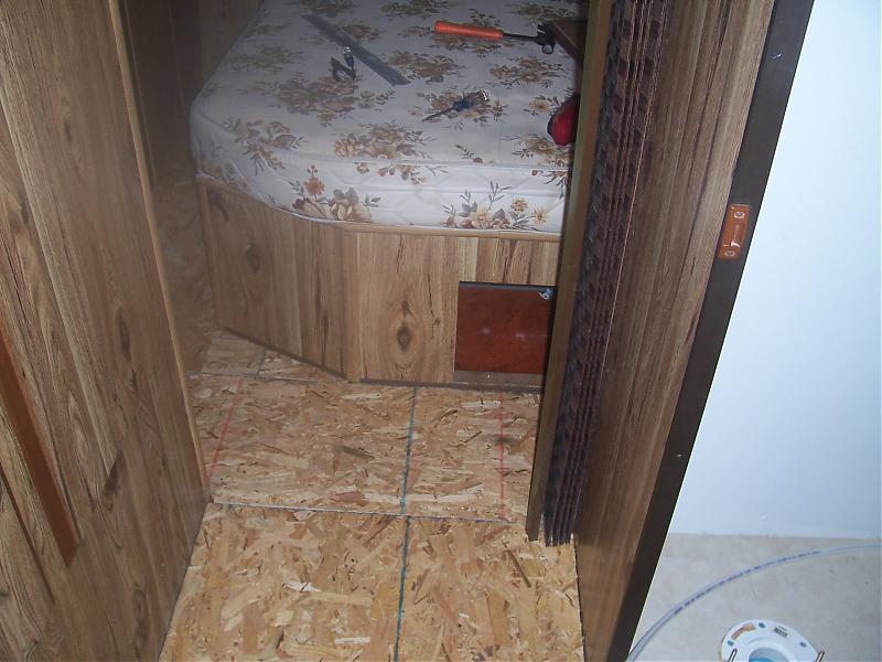

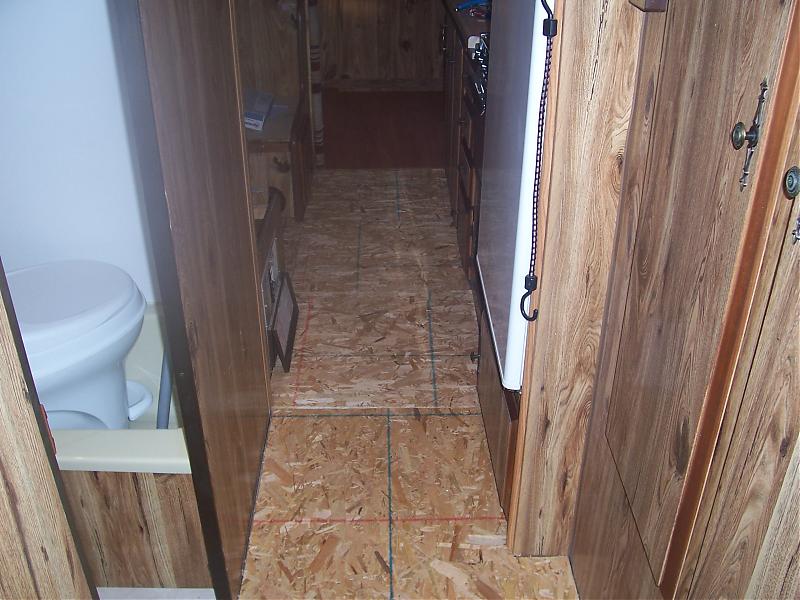

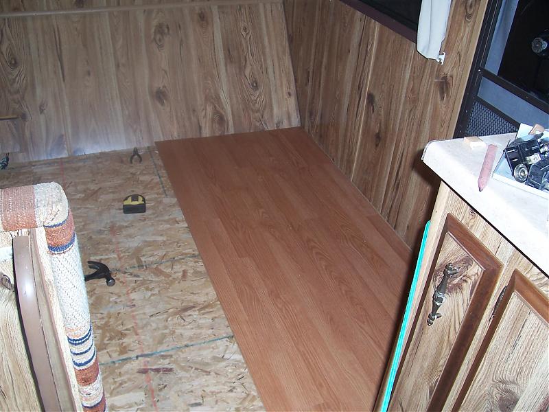

I worked yesterday and finished today of covering the rest of the floor with 7/16" OSB. Combined with the laminate floor there is a very little height difference. I would've like a little larger piece of OSB, but I'm not sure who actually carries 1/2" anymore around here and besides I had the OSB sitting here in the garage and I got some of it out of the way. Other than a badly bruised toe from dropping a full sheet on it, it didn't cost me anything.
Finally the last pic is of the laminate floor we are putting down. It says to put down some foam. I wasn't planning on doing that as I don't think in a camper it would be necessary, anyone else think I should? BTW, in the one OSB pic you'll see a lot more floor looks like it is down. That was Monica's attempt. She wasn't alternating the joints or anything.
BTW, if I'm using too much space or nobody cares, I'll stop. But if you want me to, I'll keep documenting the process.
Yes! I'd put the foam under the laminate. It'll reduce movement of the laminate (and probably squeaks) as well as increase comfort and insulation.
